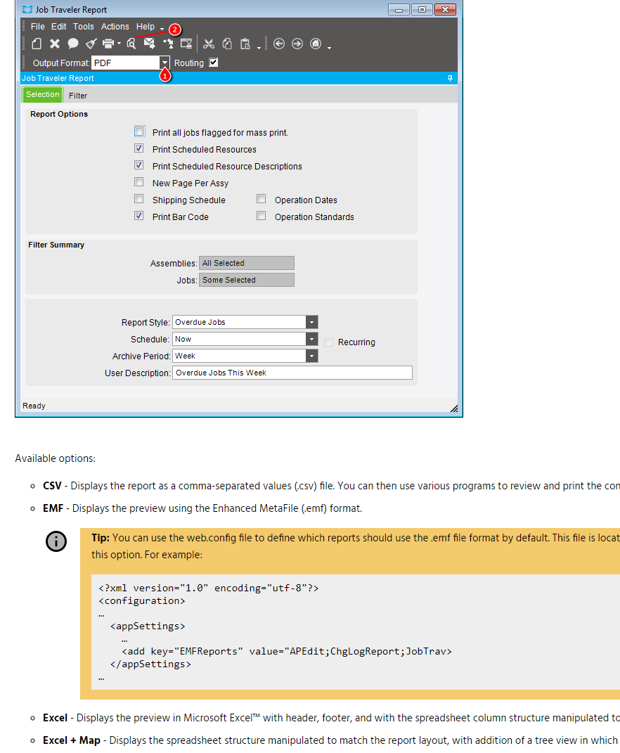

Have a SSRS Report that is sent to Doc-Link APM for ‘OCR’ so it can be emailed out per an email on the form. With SSRS Reports the Default Render Format is PDF, but APM cannot ‘read’ the PDF because it’s an image PDF. The only way to get APM to ‘read’ the form properly is if the User changes the Output (SSRSRenderFormat) to EMF before they send it to the APM printer.

Did you try this?
Make EMF the standard vs PDF
Add to web.config in appsettings for whatever report you want defaulted
<add key="EMFReports" value="POForm;ARForm;RMAForm" />
You have to add it to the web.config there is no other way to customize that toolbar at this time easily.

I kind of learned the hard way during an upgrade from E9 to an early version of 10.0. There were a couple of fixes introduced, shortly thereafter, and are in KB0029770 and KB0051061. Rumor was it would because a Report Style setting at some point, but I am guessing that did not survive long once APR came along. I know you can also work around this using APR / Auto-print too.
It is documented in epicor help but I learned it from Dan Pringle from Epicor when he was helping us with APM long ago.
So the key value is a list of ReportID’s.
If I want a specific style to use EMF, but all the others to use PDF, I’d have to make a new ReportID with the style I want to use EMF. And specify that new ReportID in web.config.

BTW - does anyone know what other key’s can be used for the other values in the Dropdown?
I have a report that always needs to be exported in Excel format and another for CSV.
I’ve tried many and nothing works:
ExcelReports FAIL
Excel FAIL
XLSReports FAIL
EXCELOPENXML FAIL
CSVReports FAIL
I am 99% certain this only works for EMF.
