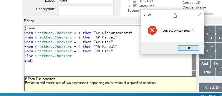

Any idea why I may get this error in the syntax? I haven’t used the case statement before
Your help is appreciated!
Pete
The error is because the text you copied has “Fancy Quotes” instead of "Normal Quotes".

I seem to be getting that same error no matter what quotes I use. also tried single quotes. Any other thoughts?

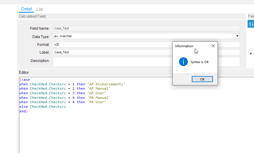

Those need to be single quotes around the strings, like:
(case
when CheckHed.Checksrc = 1 then 'AP Disbursements'
when CheckHed.Checksrc = 2 then 'AP Manual'
when CheckHed.Checksrc = 3 then 'AP User'
when CheckHed.Checksrc = 4 then 'PR Manual'
when CheckHed.Checksrc = 4 then 'PR User'
else CheckHed.Checksrc
end)
It definitely would be the single quote '

Thanks - that seems to have done the trick:
