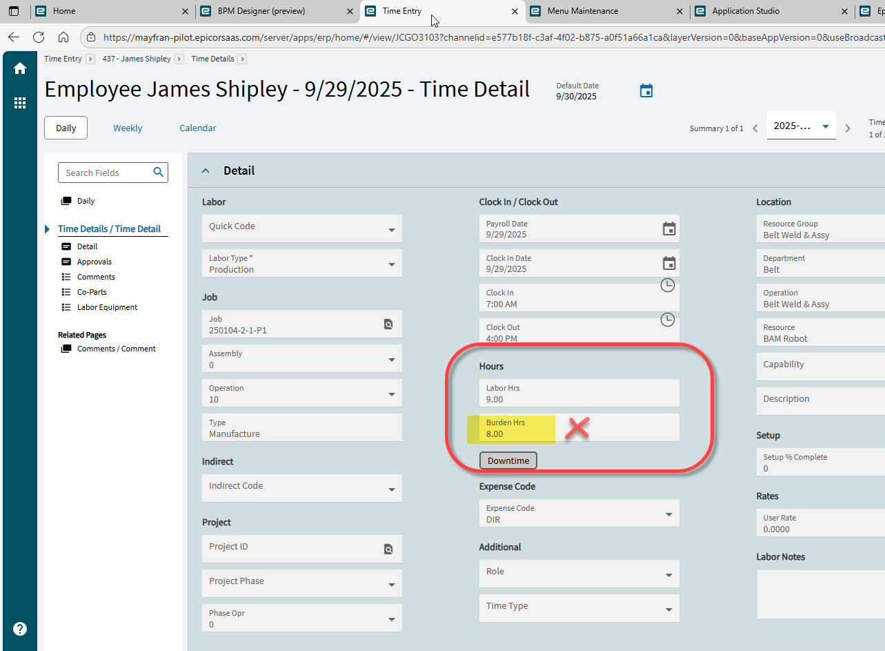

Hello, I need to create a customization on the Time Entry screen to enforce a business rule we use. The rule is that the burden hours should equal the labor hours. My question is what do you all think would be the best way to implement this? I can think of a few different ways, possibly all acceptable:

OK I wasn’t even aware of that setting. I picked a user that had that setting true, then I tried changing the labor hours and it seemed to work (the burden hours updated to the labor hours). I need to check into this a little more. We already have that option set on resource groups (in v10.2) so I don’t know why we would need that customization now. Let me investigate a little…

OK so after some discussion with my coworkers and testing, we DO need this somewhere. The burden hours does not update to the labor hours when you recall and update a time record. So my original question as to where this is best handled is probably a BPM as @dcamlin suggested (and thank you for the code!) I will try that route and may be back for more questions.
