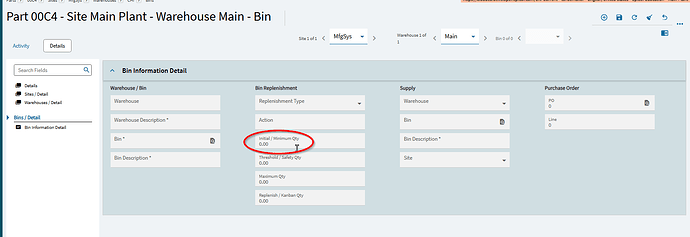

I was thinking about Bin’s, and the fact that we do have a minimum value associated with them for Kanban Replenishment. Sorry to say, this is a reactive value… in other words, the system doesnt tell you to act on it until after you are below the minimum.. but there is also a “safety” value… that can be above your minimum value. If you have someone monitoring the kanban board, this will show a warning when you are below that threshold.

@timshuwy - I did originally think I could power some kind of alert with the minimum setting on the bin as you have shown. But Bruce’s statement got me thinking - wouldn’t it be nice if we just didn’t show it at all?
