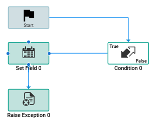

Originally I created a Method BPM on the JobClosing.OnChangeJobClosed directive as a Pre-Process.
It worked fairly simply, if the user was apart of a group, set the field back to false and raise an exception.
Now, the exception did pop up for the user, however, the check box was still ticked and would still process to complete the job.

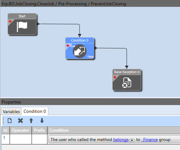

Your BPM should work, but I would try it against JobClosing.CloseJob.
This is what I have in place.
And I didn’t do any sort of Set Field. Raising an exception will prevent any changes they attempt to make when they click the Close checkbox so both Complete & Close revert back to false automatically.
Hi David,
Thank you for the solution, this worked perfectly. Guess I was over complicating it by thinking it needed to go before the CloseJob function.

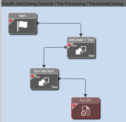

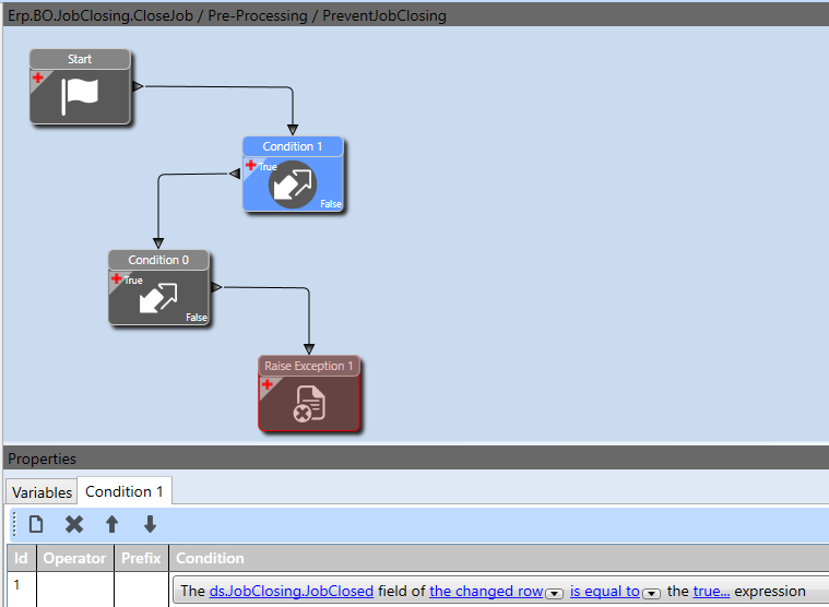

Crap, yeah, the JobClose method controls Completion and Closing, but you can get around that very easily…
Just add another (first) condition to check if the JobClosing.JobClosed = true.
If the Job Closed checkbox is true (they’re trying to close the job)… THEN make sure they have the right privileges… if not, FAIL.
If they only click the Complete checkbox… and JobClosing.JobClosed = false… then the method runs successfully and only completes the job.

Here you go @Mark_Wonsil, I fixed mine.
Ahh I did try this sort of method but I think my Condition for checking if JobClosing.JobClosed = true wasn’t working correctly,
Now implemented this and it now works the way they want it. Thanks again for your help!
