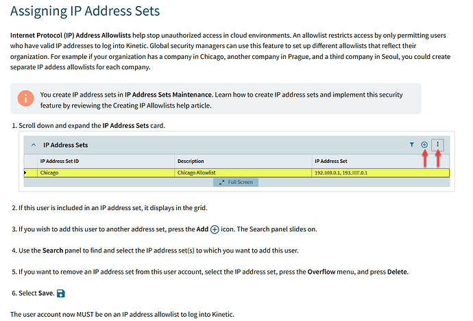

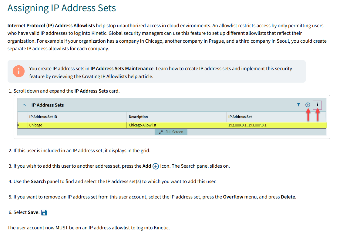

ok so it seems that at last in 2025.2 they added IP Address Sets, and you can assign a set of IPs there and then assign that to users like @aosemwengie1 sugested.
So now you can create Ranges by Location and assign them to users

Welp… I’ve tried to use it, I think I set it up correctly it appears to not do much of anything. However I am a Global Security Manager maybe it ignores the rules if I’m all powerful?
Revenge Of The Sith Power GIF by Star Wars
I would have to create a lowly account to mess with I don’t have the time or the crayons right now. Acording to the help it should work :grimacing: but I guess take that with a :sheaf_of_rice::salt:
