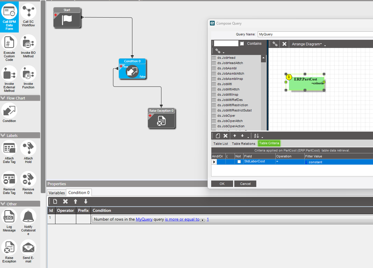

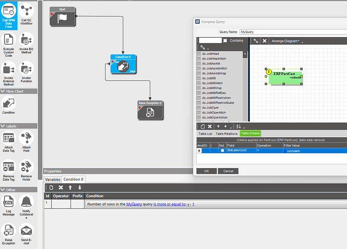

So we had this BPM run on the job entry level, that way a new part can be added, MoM’s can be updated, etc etc without cost being entered. this BPM will stop the user from entering the part onto a job assuming its total cost is equal to 0.
  • Open up Method Directives, search Method Code and change the Service Name to JobEntry.
  • Click Search and find CheckPrePartInfo.
  • Create a new Post-Processing directive
    *** Im partial to using the query conditions but im sure there’s multiple ways to do this next part.
  • create a condition using “the number of rows in the designed query” option
  • I used thePartCost table and set a criteria on that table where StdLaborCost <> 0 (for testing i only used stdlaborcost but you should use all of the fields with AND flags. that way it’ll check if ALL of the fields are empty and only if all are 0 will it stop the job from being made).
  • Click ok in the baq window and add a Raise Exception flag. Enter whatever text you’d like here to be displayed to the user creating the job.
  • connect the TRUE side of the condition to the Raise Exception
  • Save and enable the BPM!

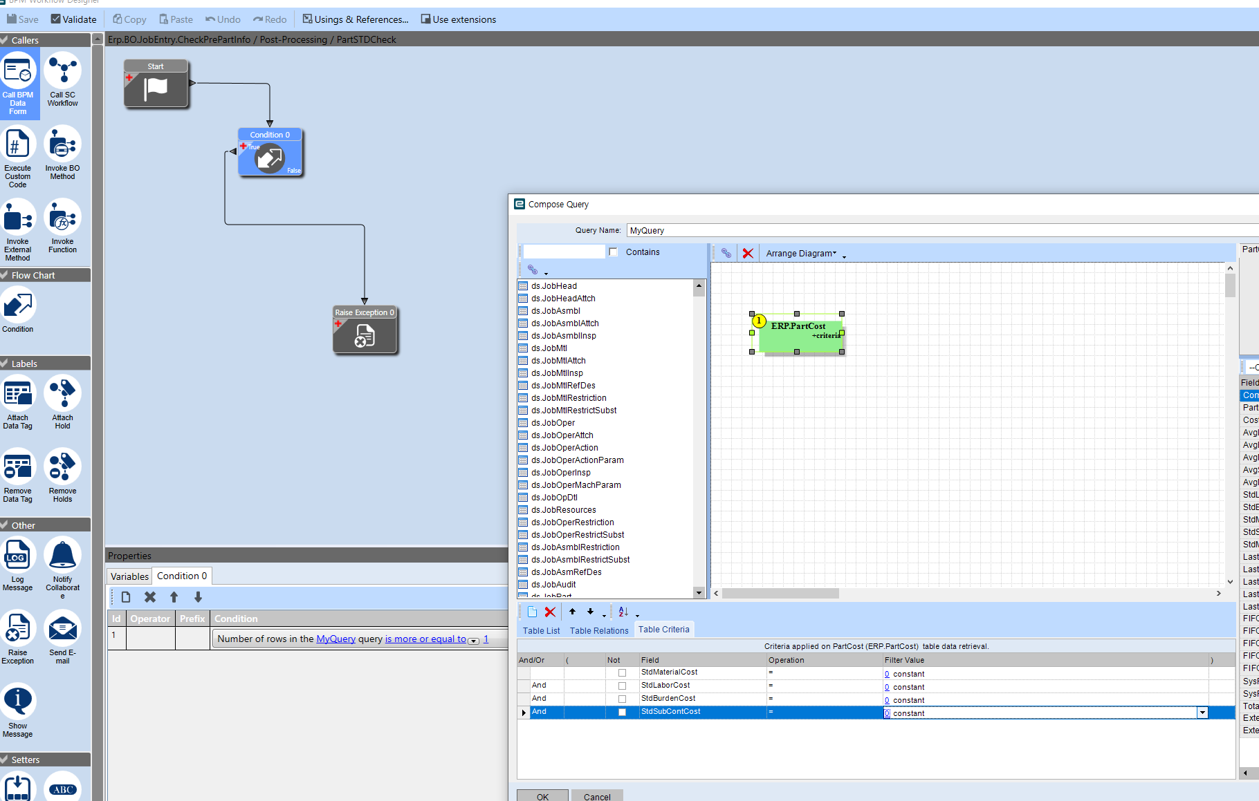

With your help I created this BPM. And I have a few questions.
  1. Is this warning just a message or does it stop job creation?
  2. Does this feature apply to both materials and products in a Job?
  3. Does this feature work when I enter all the details of the Job and then save it? Or when I enter the part that doesn’t have a STD?
    Thanks once again!
  1. it raises an exception so it will not allow the user to complete the JobRelease Action.
  2. i believe its just the part that the job is making. We had a few materials with no costs and it only raised an exception when the top level part had no costs attached.
  3. the way it worked for us as soon as you tried to release the job it would block you from doing so and it would let you know why its being blocked. looking back at the bpm i used in the example i believe this would still be the case. Instead of JobEntry being used in the first step you could use the JobEntry.ChangeJobHeadRelease service which would block the user once they tried to release the job. that way you can save the job without an issue and itll allow you to update the costs, then go back to your job without losing anything

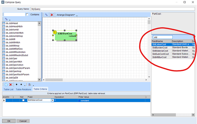

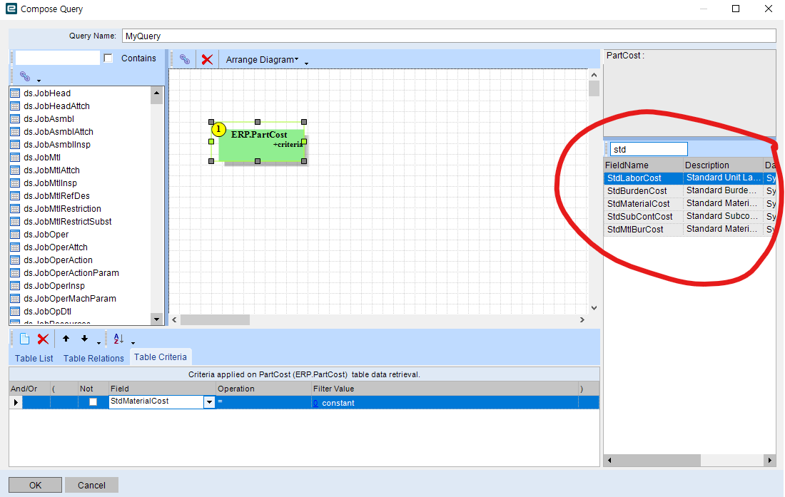

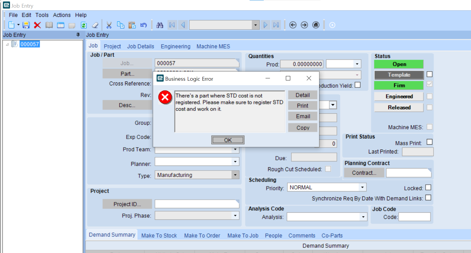

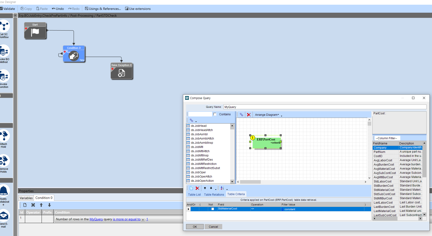

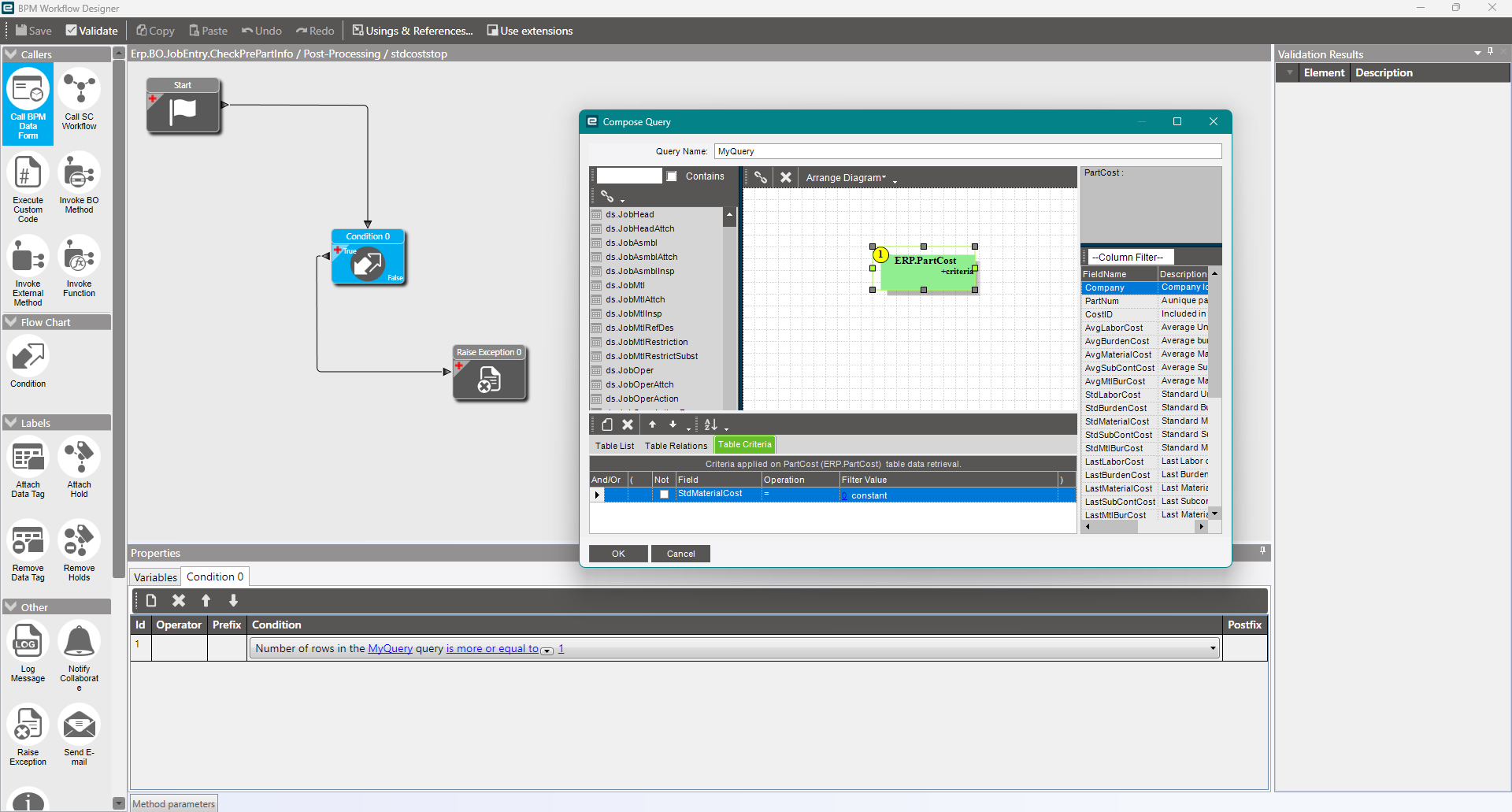

With your help, I completed my BPM. And today, the production team attempted Job Entry for the first time. However, all parts, whether or not there was an STD, were blocked with this message.
Can you please help me see what’s wrong with my BPM?

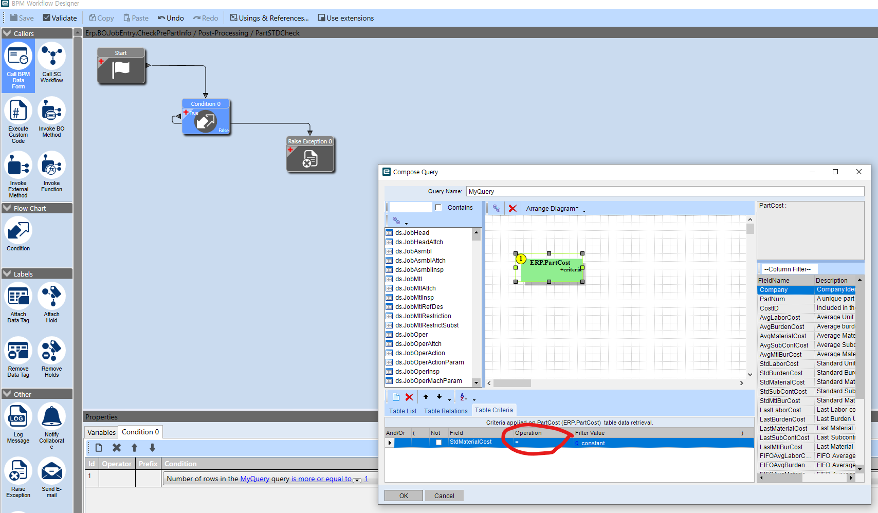

I tried putting “=” in the Operation in Table Criteria, and also “<>”. The same thing happened in both cases.
in your query change the <> sign to = 0
right now your query is saying “if the StdMtlCost does not = 0, raise the exception” which would make this pop up on any good part with costing.
In the screenshot above I only showed “<>”, but I actually tried “=” too. However, when I tried “=”, all parts with or without STD passed without raising an exception.

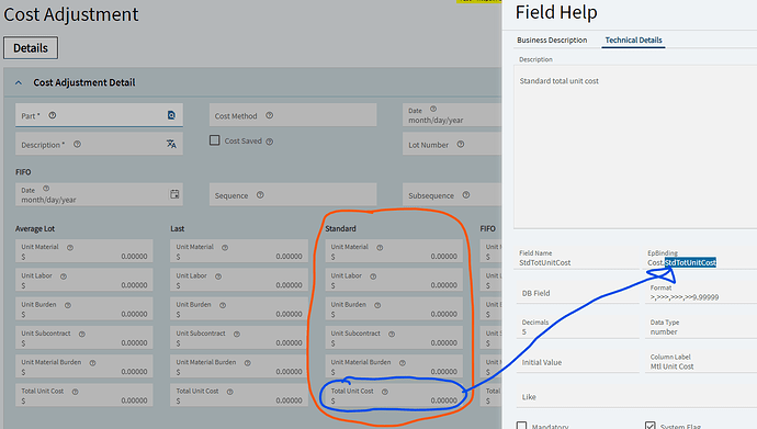

A much easier method, but im sure there was a reason i didnt use it in the past, or maybe not lol, is to use the total cost field from cost management. so in your query replace StdMaterial with StdTotUnitCost = 0. this does the same thing as my 4 item list above but just with one field.

Actually, I have already tried several things. I already tried adding all std cost fields, but got the same result. All parts were blocked, with or without STD.
I tried several different ways, but every time I got the same result for all parts (either all parts were blocked, or all parts were opened). So doesn’t this BPM look at all the parts?

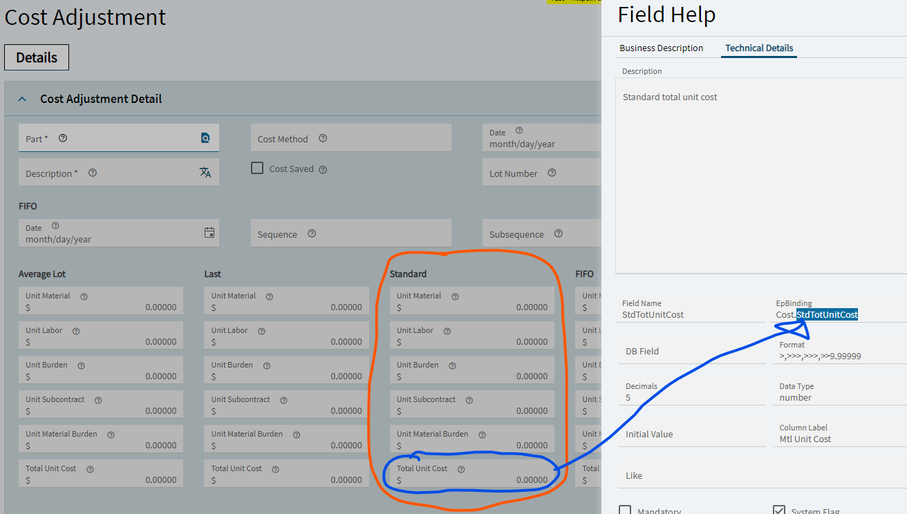

And the StdTotUnitCost you mentioned is not in Field. In my other BAQs, StdTotUnitCost was created using a calculated field. For reference, my company only uses MaterialUnitCost. That’s why I only added MaterialUnitCost in my Query.
I see it. You have no filter on PartCost related to a part number. That query is checking all parts all at once, and yeah at least one of them in the entire database has no standard, so the condition is always true.
Furthermore, if you have multiple cost sets, you need to filter the CostID as well.
this is weird…i just rebuilt it the same way as you and it allowed me to release a job that had a stdmaterialcost of 1 with all others 0. i ran it with a part with no costs filled in and it threw the error.
ive gotta ask because i cant think of anything else…what does the cost adjustment screen look like for your 000057 part?
and for the record, heres my bpm…i dont have any part filtering in the query, just the partcost and stdmaterialcost=0 @JasonMcD
I can’t see how that would do what you want if you don’t tell it what part(s) to look at.
I’d expect a join to JobMtl or something. (don’t use tt tables though).
