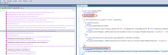

So instead of custom mod’ing the DLL and having to recompile and redeploy everytime this customer upgrades I have decided to try and pull this into a BPM. But I have never attempted to pull a BO.Service Method into a BPM to manipulate it before. I reviewed both the ICE and Customization guides and couldn’t find any documentation on the mechanics.

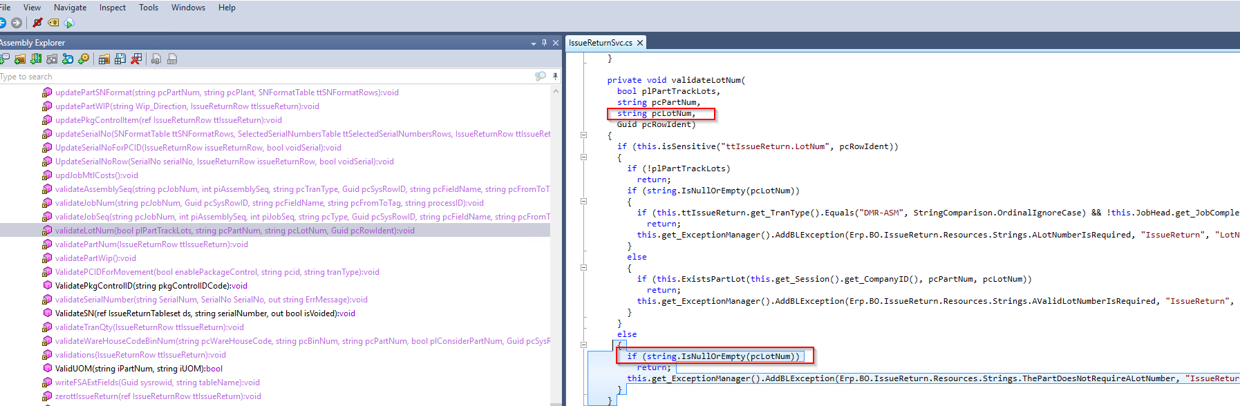

Within the validateLotNum method from the BO.Service.IssueReturn there is a pcLotNum string field that gets checked for empty and then returns the message highlighted below in the screenshot.
I either need to suppress that validateLotNum method OR pass a value into the pcLotNum before it gets checked but I have no idea on where to get started with this.
