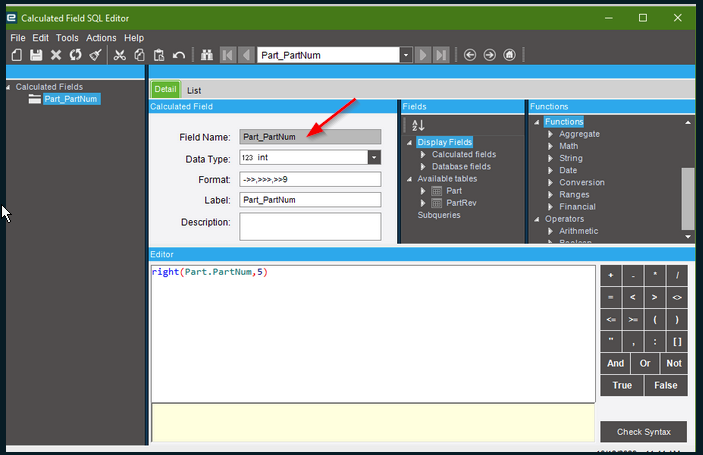

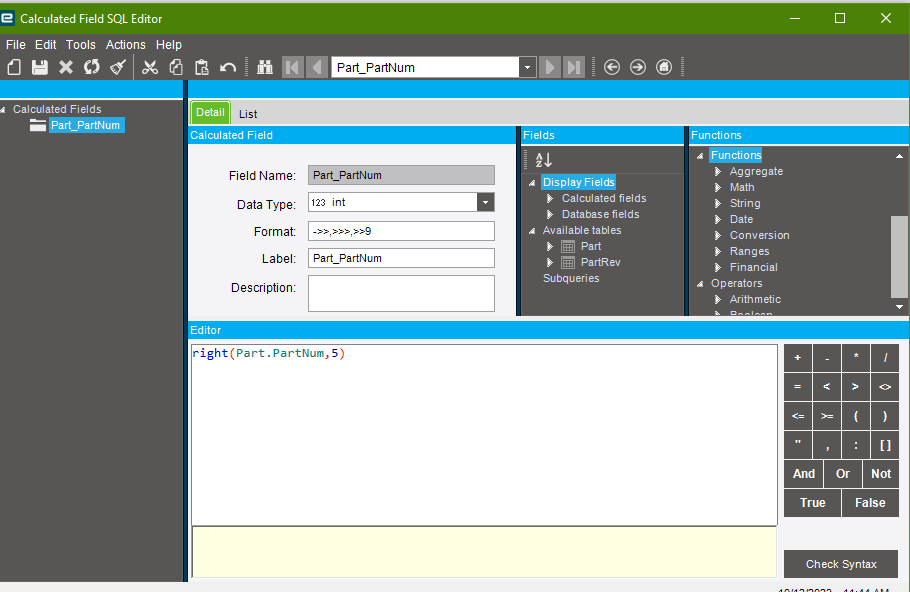

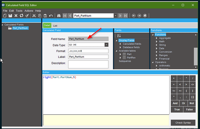

This is what I have but its returning an error when I test the BAQ.
Your new calculated field type should be an nvarchar, not an int.
Are you trying to filter to only show 5 digit part numbers? Or only show 5 digits of the part number?
What @NateS is showing you is going to show you 5 characters of all part numbers.
You’ll need to to a count of the characters and then filter by that result.
Yes, Great point Brandon!
Also, one more thing I noticed. Naming calculated fields the same as your regular fields can mess you up. You want to make sure that doesn’t match existing fields or reserved words. (Like Count, or Sum etc.). They will get you stuck.
