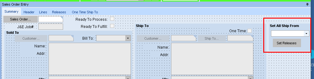

I added a field and a button to the Summary sheet on the Order Entry form, to allow the users to automatically update the Ship From on the OrderRel lines.
The user selects the desired warehouse from the drop down (which in your case would be a date control for the desired Promise by date). Then clicks the button.
Here’s the code for the button click.
  • Variable bcmbSiteWhse is the control that holds the site and warehouse. Because I need to set the site and warehouse it’s a combo of the two with a ~ separating them. You won’t need to do all that. Just get the date from your control.
  • my dataview is on the OrderRel, you’ll want to use the OrderDtl.
  • the lines between relLine.BeginEdit(); and relLine.EndEdit(); are the ones that update the values on the form. This is where your updates go.
