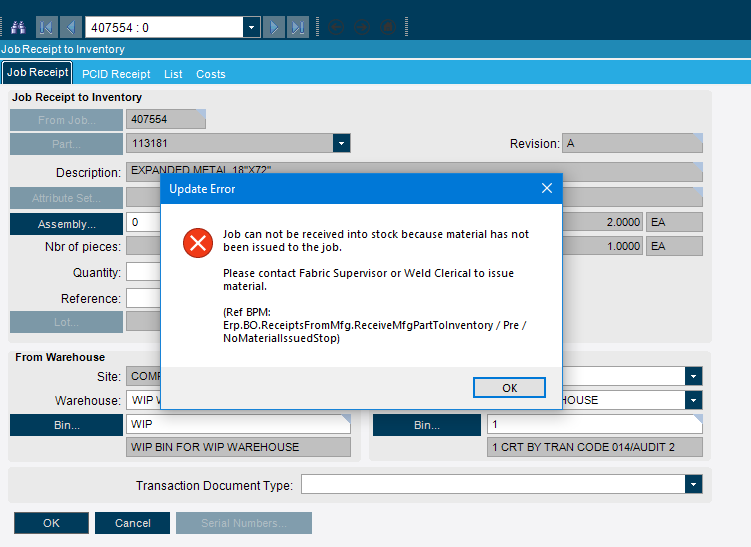

I’m making a BPM to pop-up a warning at job receipt to inventory when less than .001 quantity has been issued, but I’m getting a compile error:

@kylepbsps - Not receipt entry, but Job Receipt to Inventory. We’re also stopping the receipt of jobs into inventory that didn’t have any material issued. Figure it’s better to stop it earlier than have our cost account deal with a job that has zero material cost!

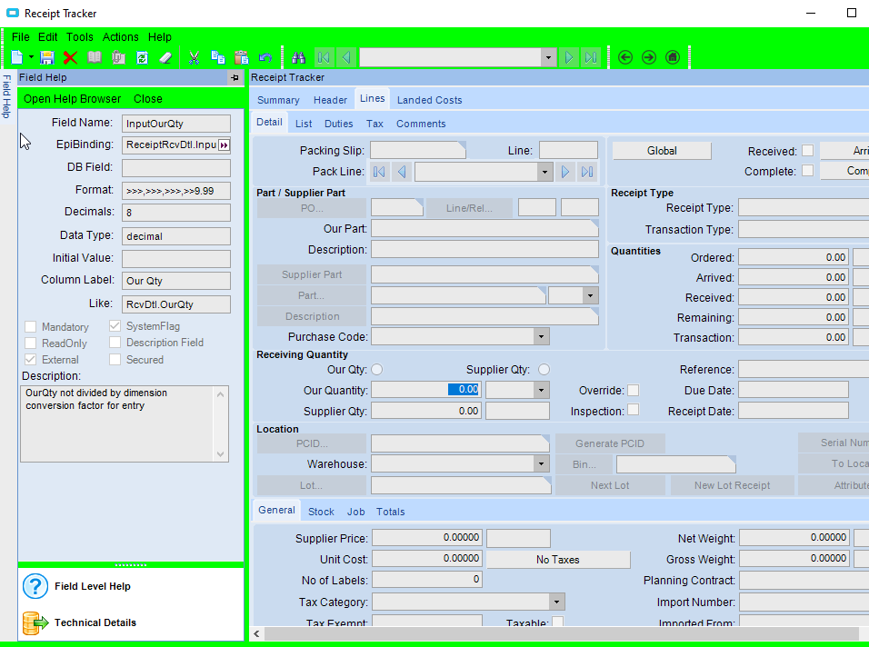

Look at this field maybe if you’re still having issues.
