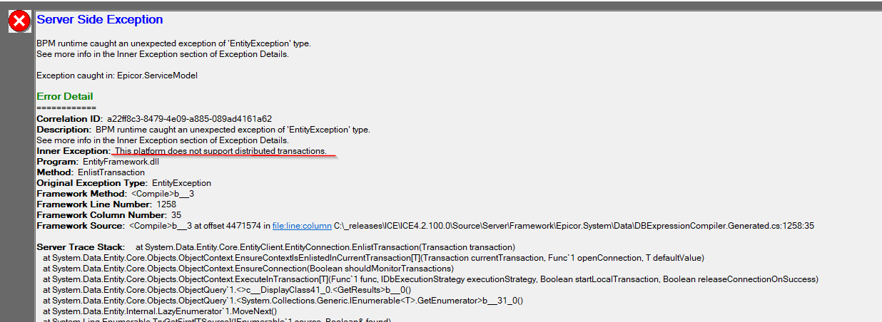

Hi,
Did it in this way, it seams that it work until there is no iteration id db table, but when i iterate I get this error:
Don’t know how to solve this. My code look like this:

LINQ won’t work here because you need the whole part dataset to work with. Start the trace, go to Part Entry and add a whse to a part. Stop the trace, go to your trace log and see what methods are called there. Assuming you already covered the cases where those warehouses are already added and you don’t try to add them again, you’ll need at least the following:
Part.GetByID
Part.GetNewPartWhse
Part.Update

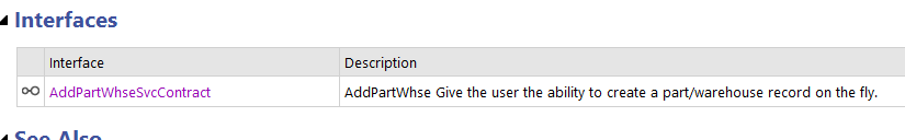

Don,t know why but this works, but if you say that it needs to rebuild full dataset I am afraid that this could do some bad stuff. Althought BO ref describes this method like this:

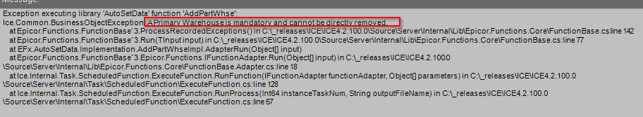

Hi,
One more question, maybe you would have an idea. If the same function submited on pilot it runs smoothly if it is submited on Live for the same part with the same conditions it runs and creates warehouses as it should but monitor displays notification:
Could it be some bo bug on environment? Because Pilot and Live Db data are equal, and script are the same
I may be way off since you’re on a totally different version but maybe you’re trying to overwrite the warehouse that’s set as primary ? Like the record is already there. Are you doing any checks to see if the warehouse is already added ?
Did some test, one difference between environments, on Live same part has a reference to the job, if I pick part which has no ref to job, then there are no such warnings. But probably until script creates warehouses and just displays warning, I can be calm, maybe :slight_smile:
