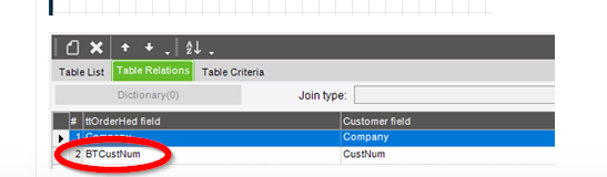

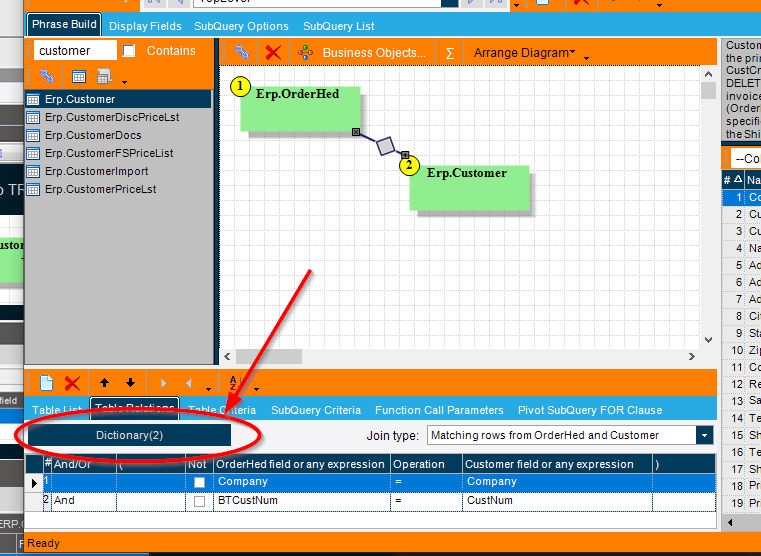

I think that your join to the customer is incorrect… you joined the customer to the BTCustomer field… change the join and retest.
Will do. Those are the fields used in when Epicor automatically joins the two tables in BAQ, which is why I used them.
Still get the false message (using CustNum)

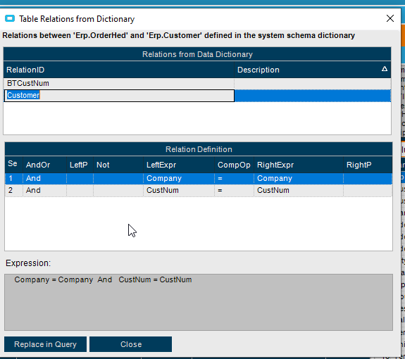

One of the things that you need to pay attention to on those auto joins is where there is more that one dictionary . There are actually 2 for this join.

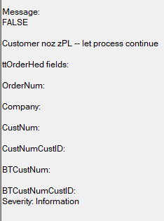

BUT, since that didn’t fix your issue, did you try raising messages that show what you think should be in your dataset? Before you run the query, put your ttresult field that you are trying to join on to make sure you are actually getting that value in the TT record. Many times the TT records don’t have the full dataset filled out, so it seems like you should be able to get info from it, but it’s not actually populated.
So the query does not appear to be getting any info from ttOrderHed:
