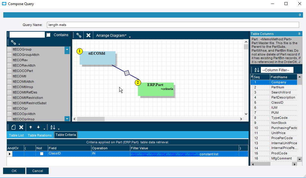

I want to see what part class a part is in when I change a related operation in the method (ECOMtl table) and set the scrap rate accordingly. The ClassID for the part is not in any of the TT tables, so I am trying to use the “Number of rows in the specified query is more than 0” to try to signal when they are in the list of the affected classes.
In the designed query I tied the ttECOMtl table to the Part table with company and part number and filter the part table for any parts in the list of classes using the “IN” operator (or whatever you call those functions)

Screen shot of the designed query
