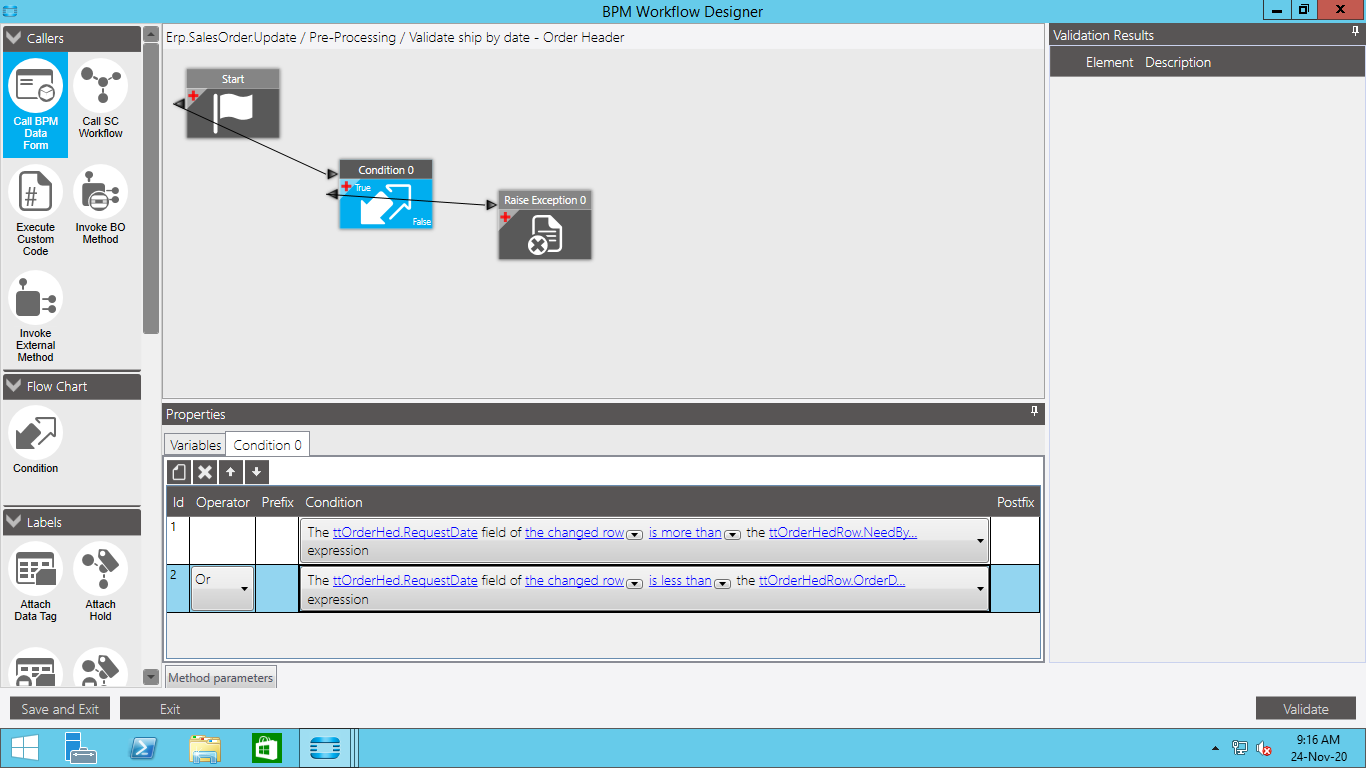

i have a BPM to prevent user from entering request date less date order date in Sales order. it worked fine. However, this BPM block “Copy order” from functioning, reason being when we choose copy order, system always set the order date to current date, so the BPM condition become true and copy order functions cannot used.
Anyway, i can control user while “copy order” function can worked?

Yes. i made a MD that throws an exception if user try to save when OrderHed.RequestDate being before OrderHed.OrderDate but i don’t want it to fire when using Copy Order.
the second option of below condition caused the copy order not able to used.

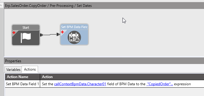

There’s no easy way to set the dates on the order created by the Copy Order function.
So Instead, I set a CallContextBPMData variable in a SalesOrder.CopyOrder / Pre-Proc BPM. Then you can check for that value in your SalesOrder.Update BPM that checks the dates.

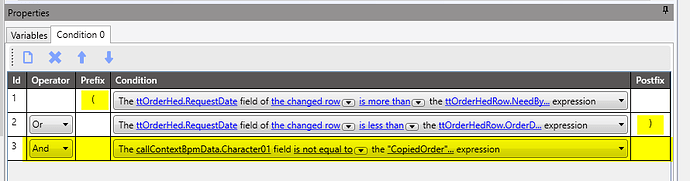

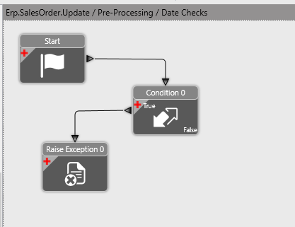

Then in your Update() BPM:
Add another condition to check the CallContext data value:

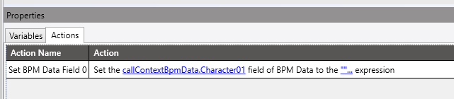

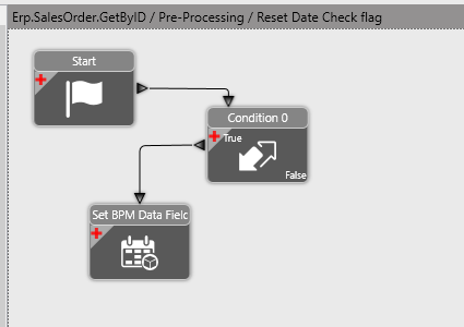

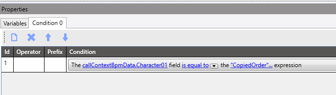

Since that Call context varible would remain active during this session of the SO Entry, we need to clear it … This can be done in the GetByID() method:
I added a condition so it only clears it if its is equal to the value we’re using for the check. This is so that it doesn’t mess with any other SO BPM that might use that same CallContext variable.
And finnaly actually clear the CallContext variable
