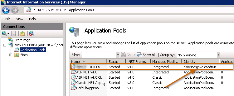

# BPM csv export to network **Category:** [Epicor ERP 10](https://www.epiusers.help/c/e10/5) **Created:** 2017-01-19 17:12 UTC **Views:** 1069 **Replies:** 4 **URL:** https://www.epiusers.help/t/bpm-csv-export-to-network/36953 --- ## Post #1 by @mmcwilliams I am trying to export a CSV to a network location as opposed to a local drive on the server. Any ideas? I have checked permissions on the folder already. This Works: Output to Value("C:\Mill2Screen.csv") . Export delimiter "," CustName JobNum Rate . This does not: Output to Value("\\192.25.1.4\Maint\Mill2Screen.csv") . Export delimiter "," CustName JobNum Rate . This does not:(Mapped Drive on Server) Output to Value("M:\Mill2Screen.csv") . Export delimiter "," CustName JobNum Rate . --- ## Post #2 by @duckor try (@"\\\\SERVERNAME\\M$\\Maint\\Mill2Screen.csv") --- ## Post #3 by @JeffSanders Did you check permissions on the share? --- ## Post #4 by @aidacra Is the identity on your Epicor appserver's application pool a domain user that has access to that location? The BPM would run under that user context. --- ## Post #5 by @mmcwilliams That looks to be it Nathan. Thanks --- **Canonical:** https://www.epiusers.help/t/bpm-csv-export-to-network/36953 **Original content:** https://www.epiusers.help/t/bpm-csv-export-to-network/36953
