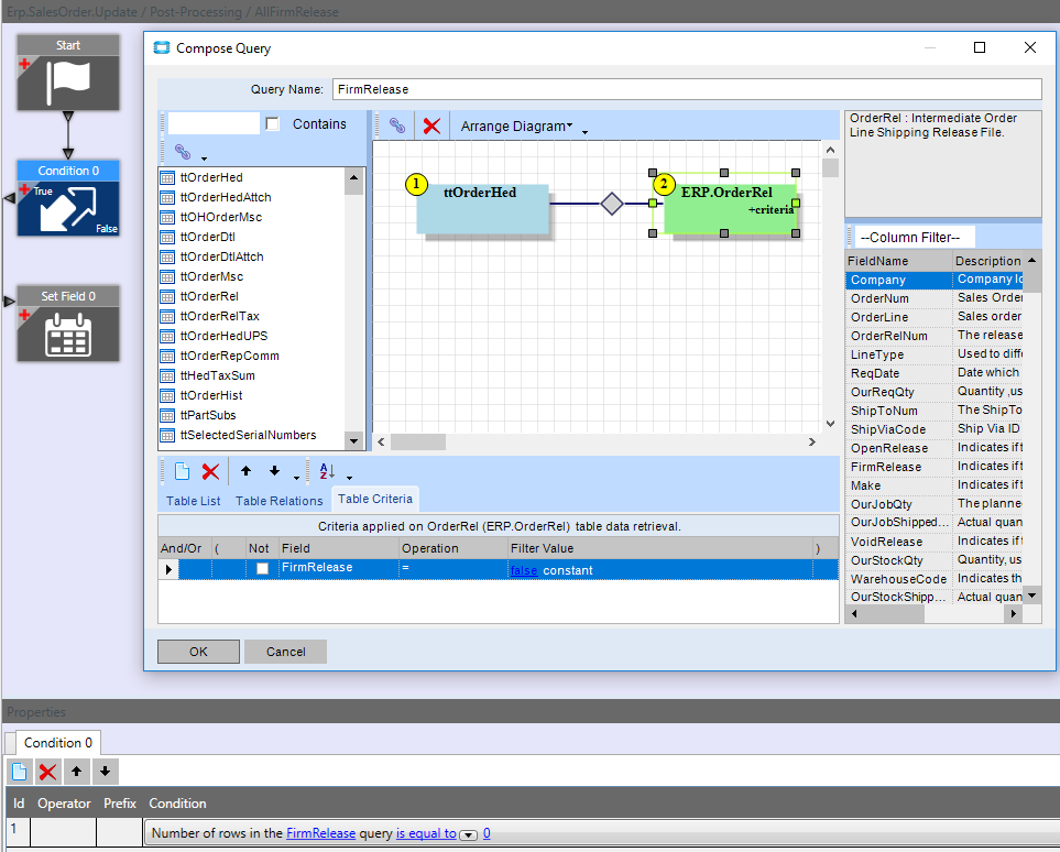

This can be done without special code through the BPM Workflow Designer.
Post-Processing Method Directive on SalesOrder.Update Method.

@bmgarver What did you use in the Set Field of a Post-Processing to actually change the OrderHed table. I don’t believe setting ttOrderHed.FieldName would do anything on a post.
i tried this and it force checks the firmrelease and firmreleaseall_c after being saved
Because “FirmReleaseAll_c” is a custom filed so you need used as ttOrderHedRow[“FirmReleaseAll_c”] = true; (or false)
