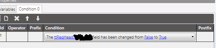

A different condition (or additional) should help:
