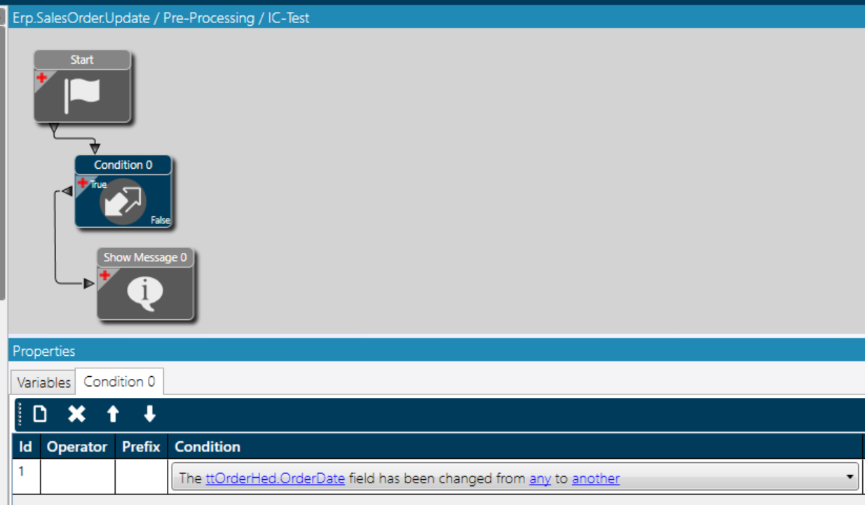

Pre process MD. Sorry not providing all the details. Here’s my test BPM looks like
Have you run a trace to see which BO methods are called, and in what order?
I think there’s a method for changing the date (might only apply to need by or shipby date changes). But if some other method changes the date before Update is called, then the date won’t be changed during the update. Update might not even be called if another method alreaded updated OrderHed.
And I think there’s a MasterUpdate (or UpdateMaster) method that might be called instead.
Not sure if it’s an option, but do you need it to only run if that date is changed or with any change if the date is >= October 1, 2021? Could you possibly write the conditional for the date based on its value and not whether the value has changed?
