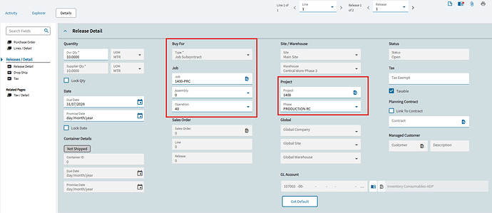

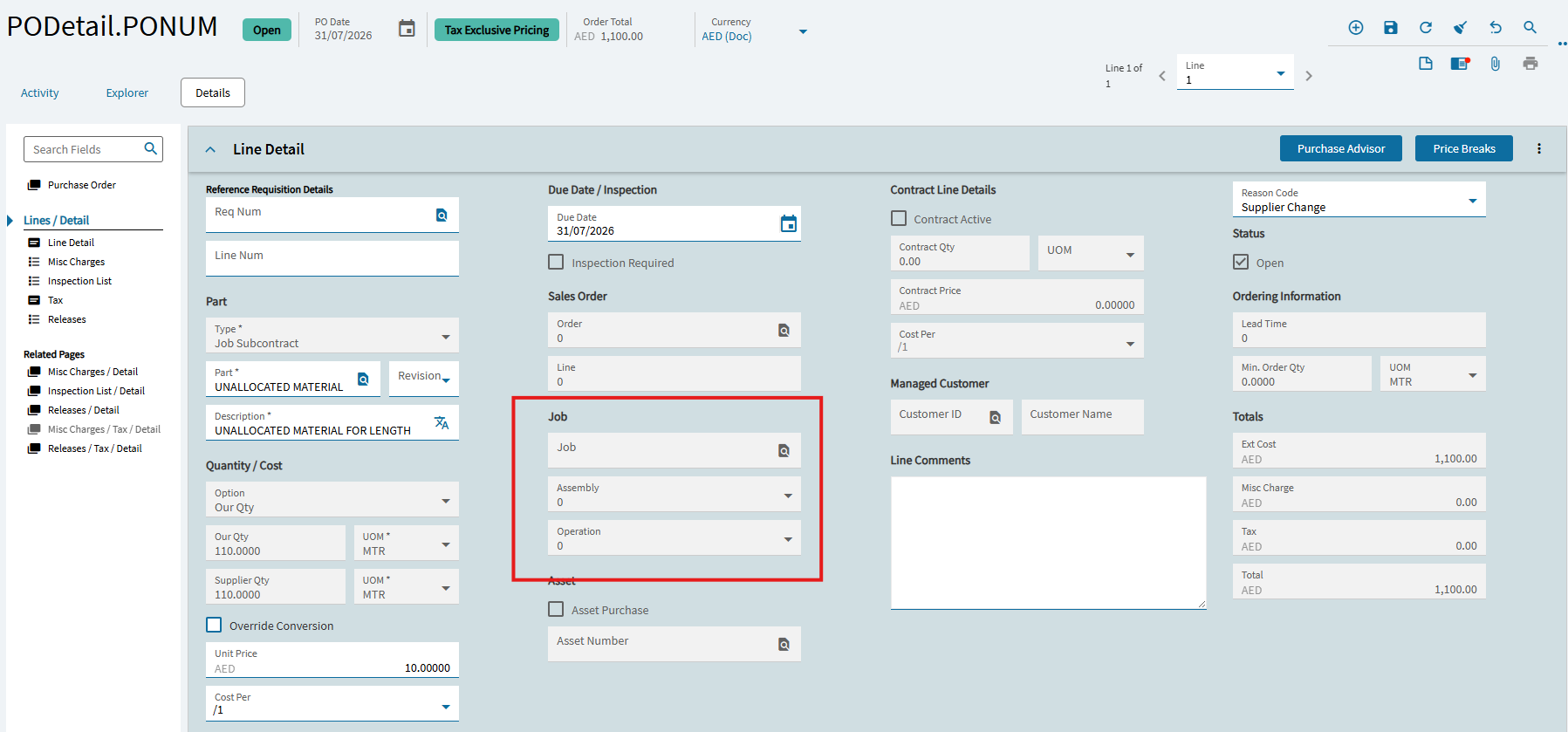

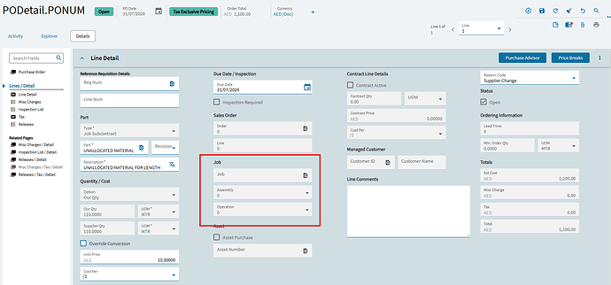

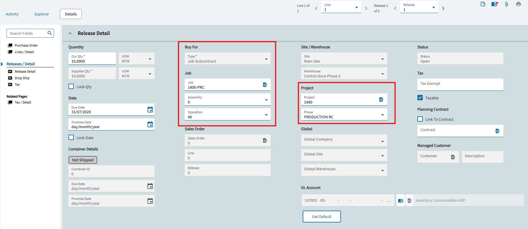

The interesting part is that PORel is happily accepting the updates through our code, but PODetail is acting like it has never heard of those fields before. :sweat_smile:

I see in the example you have 2 releases, if they are for two different jobs then that info doesn’t show at the line level.
If it is 1 release it would display the info on the line
