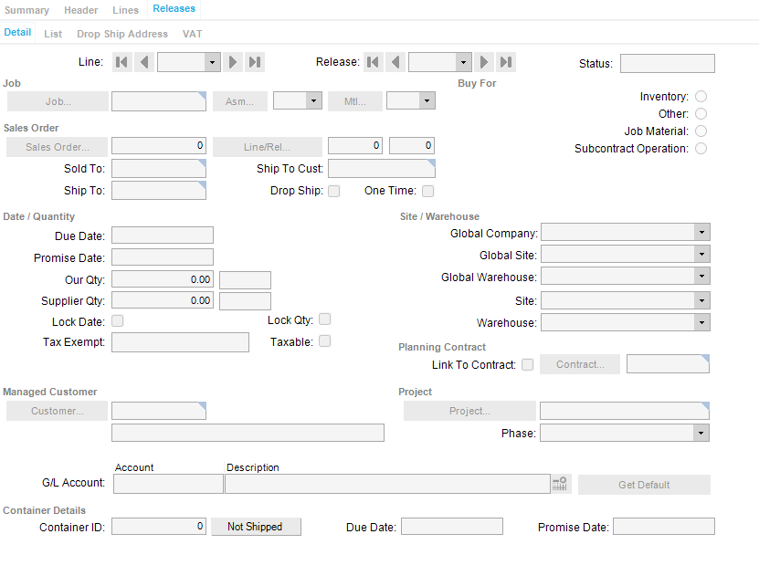

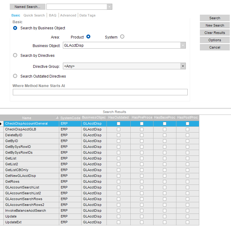

Returning to an old job now i have some free time im trying to find the bussiness object for the GL account line

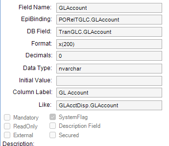

Below is the field help information.
So all im doing is making a Bpm to watch this line and after a new PO is made, if this field is empty a windows pop up to say please fill this out. Just can not seem to find the object to make my bpm work.
The one im looking at, at current is
Thanks for any pointers

For assigning GL’s have a look at PO.GetDefaultGLAccount.
Im in the planning so my plan was to have a bpm to watch the field so when they come to save the po and have forgot to enter GL code of forgot to press get defualt then a message would display reminding them to go back and fill it out as we are having issue with people not do that.

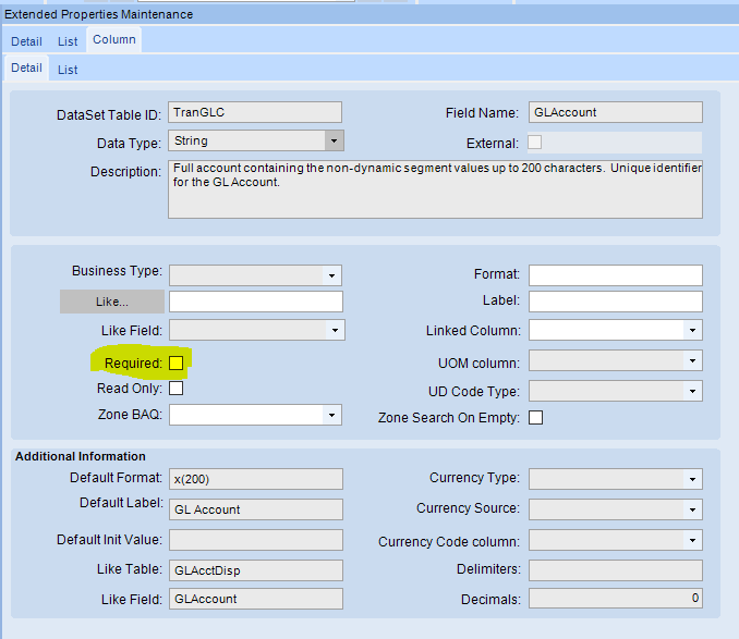

I do not think you need a BPM for this. You should be able to make the field required VIA Extended Properties:
This might work. It would come down to whether the TranGLC record gets created with a blank GL Account and when/how this gets triggered. It’s pretty easy to find out!
Seems like it does exactly what @djennings is asking for.

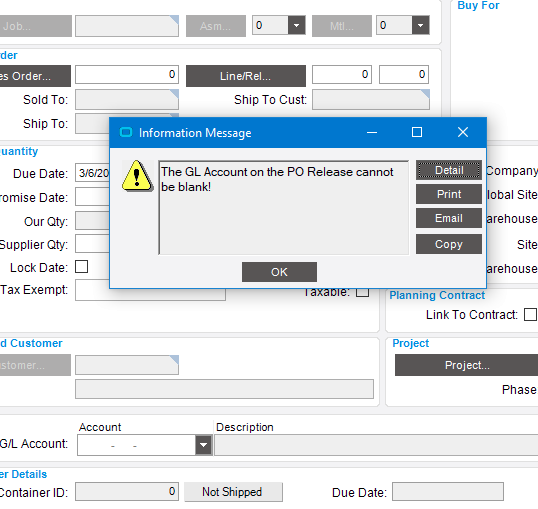

Will give this a go, if this works it will be great, its just to remind staff that the GL code needs to be added if they forget.

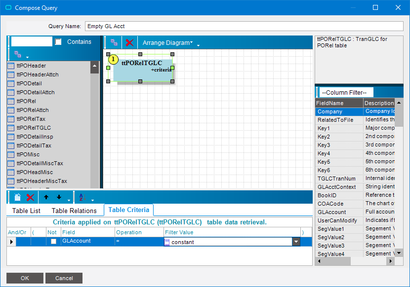

If your goal is to remind users when the GL Account on a PO Release is left blank, I think you can make a really simple post-processing method directive on PO.Update. Just a condition “Number of rows in the ____ query is more or equal to 1”, with a query filtering the ttPORelTGLC table by GLAccount = "".
Attach the True side of that condition to a warning message. For a reminder message to users, that’ll probably be good enough, but be aware there are a number of modifications that can be made to a PO dataset without going through the PO.Update method.
