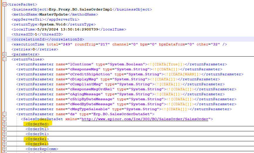

I’m not sure if that’s update or masterupdate, and I’m not sure if it sends the header row when a release changes.
Can’t run a trace right now, but if you can, that would be helpful in advising you.
I read your comments in another similar thread… I’m not especially good at harvesting tracing data, either - but I’ll re-read and try some things.
If you can’t I’ll run one later, or someone with this knowledge already will probably see it.
If the header row isn’t sent, you’ll have an issue, because if you modify the header outside of the normal operations, Epicor may complain, or you will have to refresh, or both. So some outside of the box thinking, or alteration of your plans may be in order.

Played with trace logging … and it looks like everything is here. If that makes sense.
