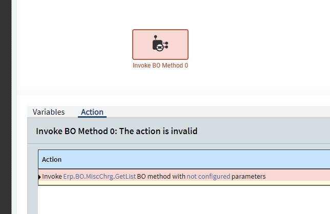

I’m attempting to follow instructions I found in a BPM Cookbook to add a Miscellaneous Charge to every order. The BPM I’m trying to create has a Invoke BO Method widget on it. When I try to click the ‘specified’ link in the Action, nothing happens. I’m expecting to see a Choose BO Method dialog. The instructions are written for Classic, but I’m using the Browser/Kinetic view.
Any thoughts?

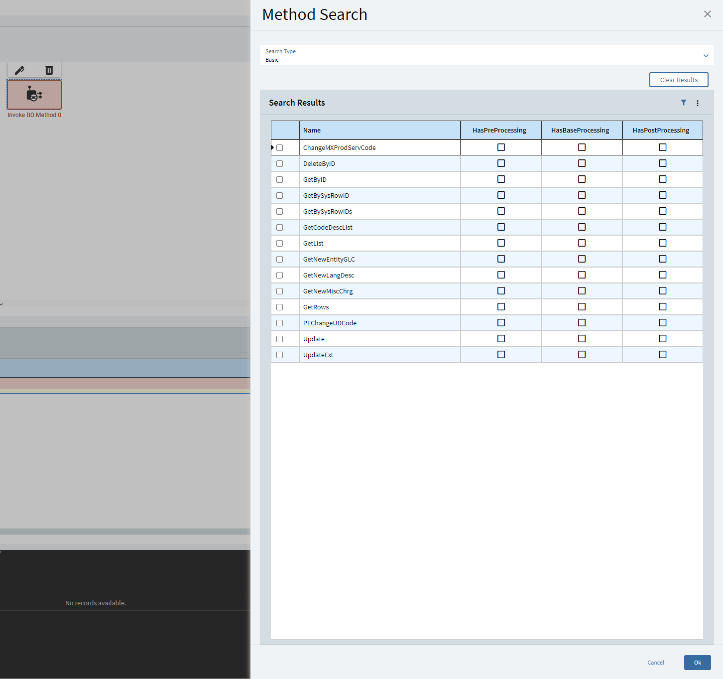

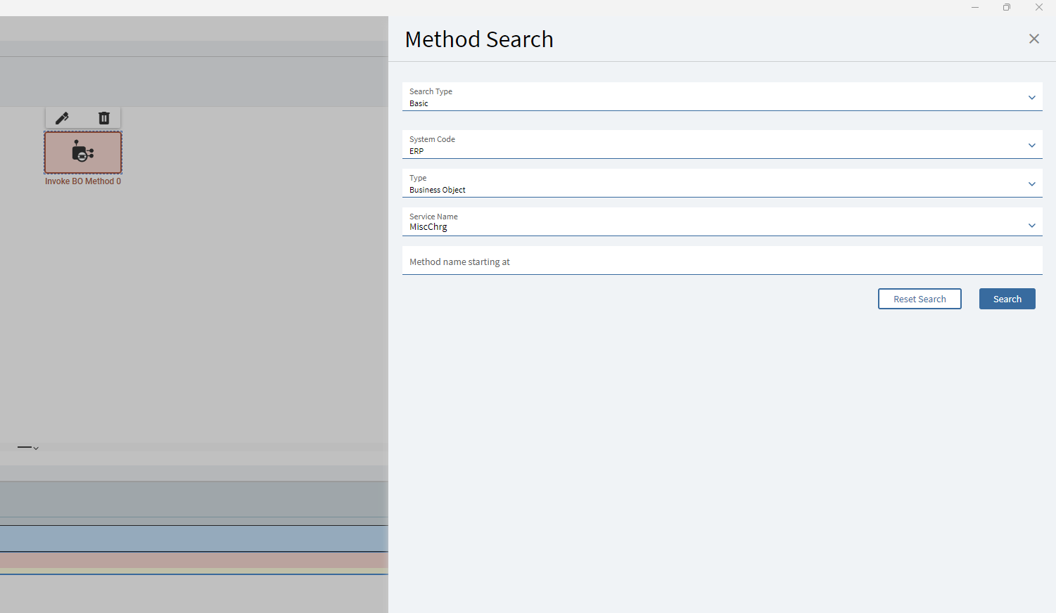

In the Smart Client, this seems to let me proceed.
Might be some version specific issue. What is you version details ?
We are using 2024.1.7 and seems to be working fine.
