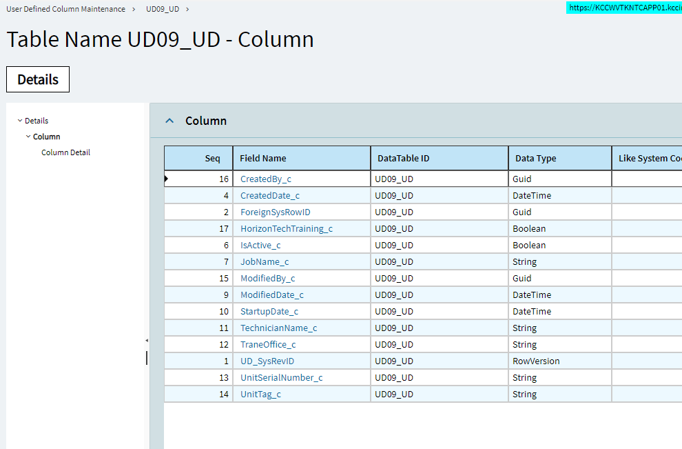

Did you re-generate the data model?
Unless you work with support, I think all the UD tables have generic field names, the _c notation is for custom fields added to existing tables. Did you ask support to add field to UD09?
I’m on prem so I can add fields to the tables. I did regenerate the data model.

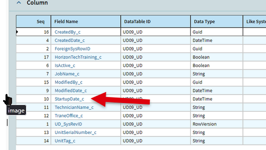

Your camel case is wrong.
Don’t forget you can use CTRL+Space in a BPM for auto complete.
Yep, I’m an idiot I didn’t catch that. Sometimes it’s the simple things :slight_smile: Thanks!
