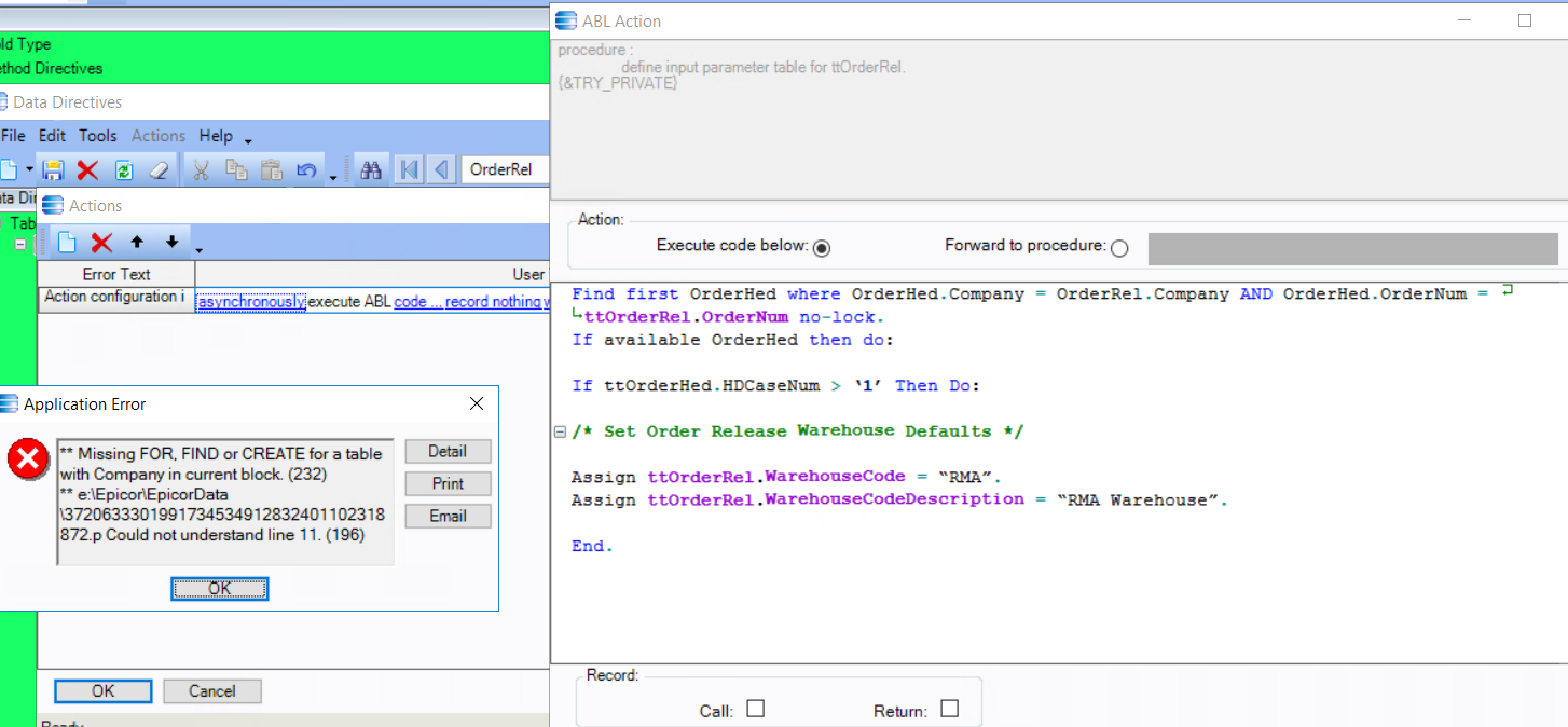

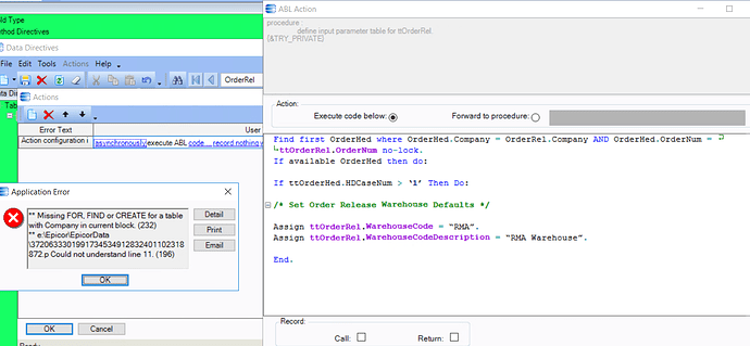

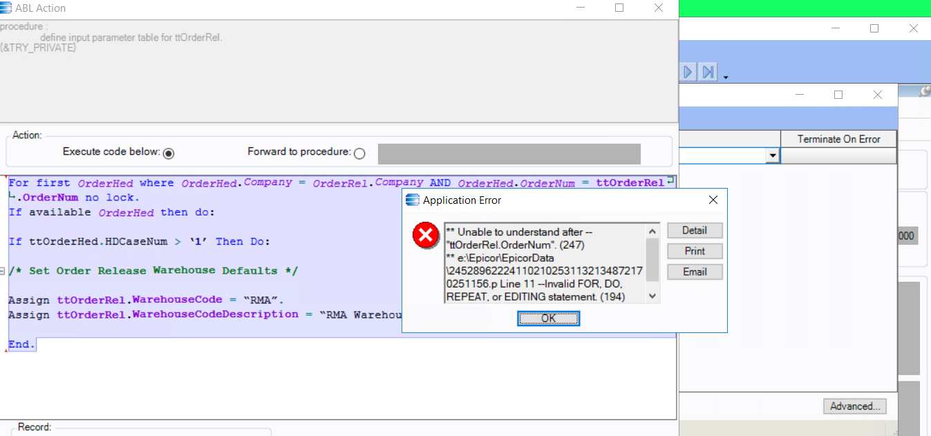

Hi Jim,
I’ve applied the below as a data directive to the ORDERREL table (standard), and got the below error message.
For first OrderHed where OrderHed.Company = OrderRel.Company AND OrderHed.OrderNum = ttOrderRel.OrderNum no lock.
If available OrderHed then do:
If ttOrderHed.HDCaseNum > ‘1’ Then Do:
/* Set Order Release Warehouse Defaults */
Assign ttOrderRel.WarehouseCode = “RMA”.
Assign ttOrderRel.WarehouseCodeDescription = “RMA Warehouse”.
End.
find first not for first :slight_smile:
change to no-lock.
As written below with the corrections, complies ok. I still think you’re better off triggering this on a sales order update method directive, as Nancy stated a while back.
Find First OrderHed where OrderHed.Company = ttOrderRel.Company AND OrderHed.OrderNum = ttOrderRel.OrderNum no-error.

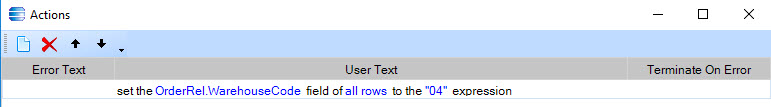

I do something similar to this, I require all sales orders to be entered into the 04 warehouse (currently for other reasons we have the default warehouse set to another one) I have a data directive on the OrderRel table set up like this:
I have no conditions set up because I want all our sales orders to go to this warehouse but I’m sure you could add something to the Conditions section if you want it to be more specific.

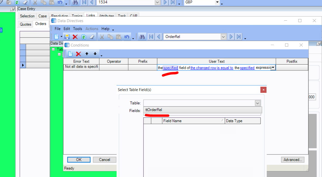

Thanks John,
When i replicate yours it works…here is where the problem is, I need the condition to be where the OrderHed.HDCaseNum is greater than 1, however when i go to apply the condition you can only select from the ttOrderRel table…nothing for OrderHed
Thanks.
Mark

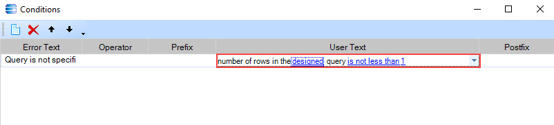

Hi Mark,
Be warned I am winging here a bit :slight_smile: so i hope you are in your test system…
I think you would need to use this option
using the design option you can configure a query, and link the OrderRel to the OrderHed tables and if that returns a value then it would perform the action.
Like i said i haven’t done this much but it’s where I would look…
Cheers,
John

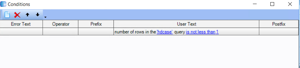

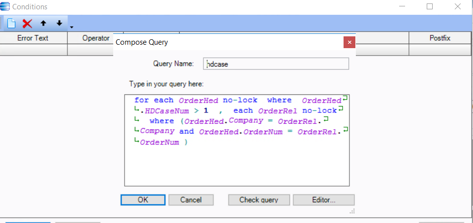

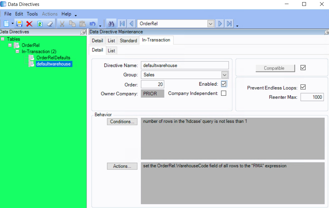

Thanks John, this seems to have nailed it.
It has slowed down the processing side but thats the “hit” with bpm’s…thank you so much for your help.
I’ll add screenshots of the fix below.:
aaaahhhhh, not quite…i spoke to soon.
I just tested putting on a normal order through order entry (not through hd case) and it defaulted to the RMA warehouse!
Hi,
Not sure about that, it would suggest that query is returning a value regardless of the OrderHed.HDCaseNum value ??
Regards,
John
