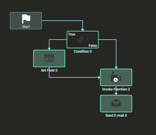

I have a BPM that I am working on which will pass some data to a function to handle.
Current Function:

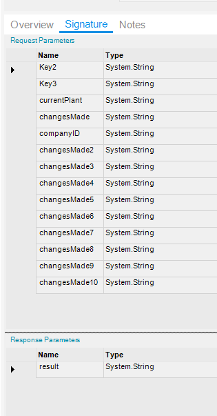

Signature:
Company is authorized for the function library and function library is promoted to production.

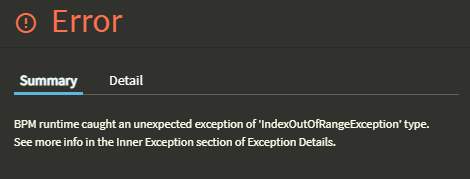

However, I am receiving an indexoutofbounds when the function is called. This should just return “test” in my out parameter and there is no other code being ran here.

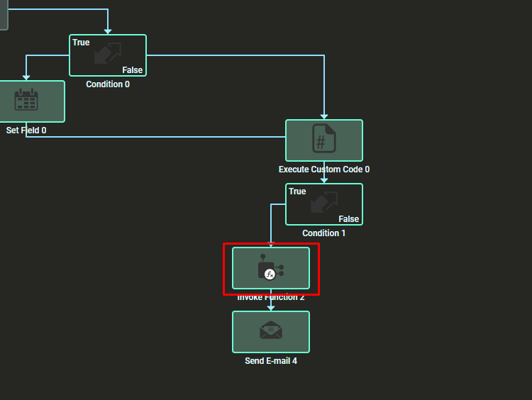

BPM throws indexoutofbounds here:

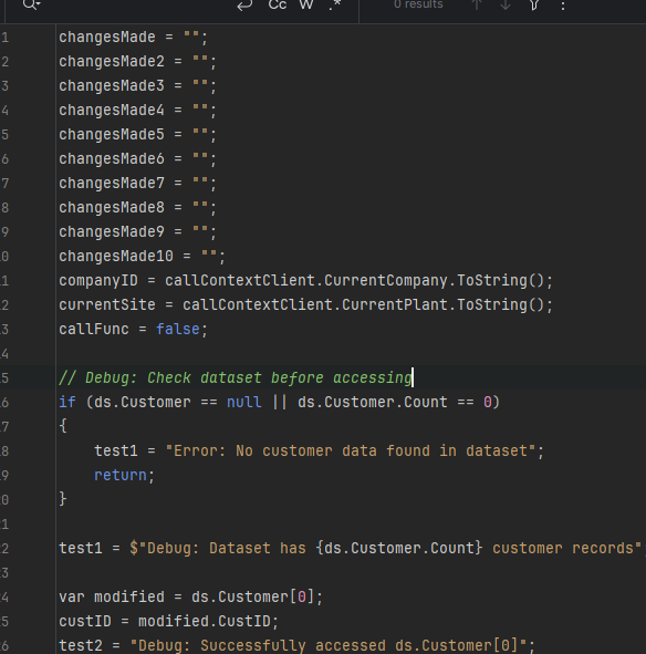

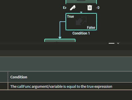

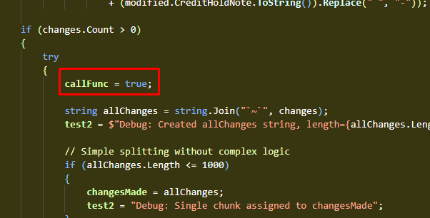

I have thoroughly tested my custom code above - this code handles setting the parameters and based off criteria the function will either run or it wont (condition block)
Condition is simple:
Inside my custom code block:
if I comment out callFunc = true; then my function does not run. This does not produce any error.
If this is not commented, then my function will run as the condition will be met and I receive an indexoutofbounds error.

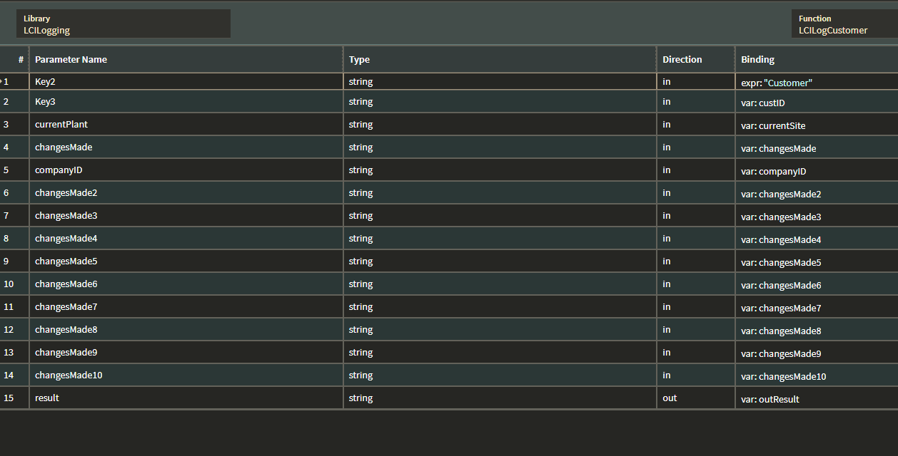

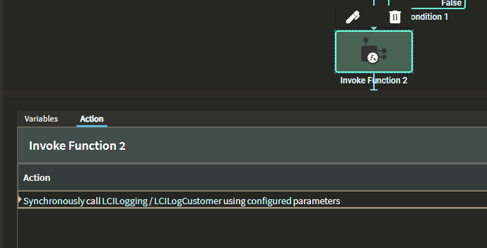

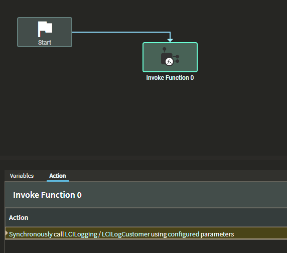

Invoke function block:

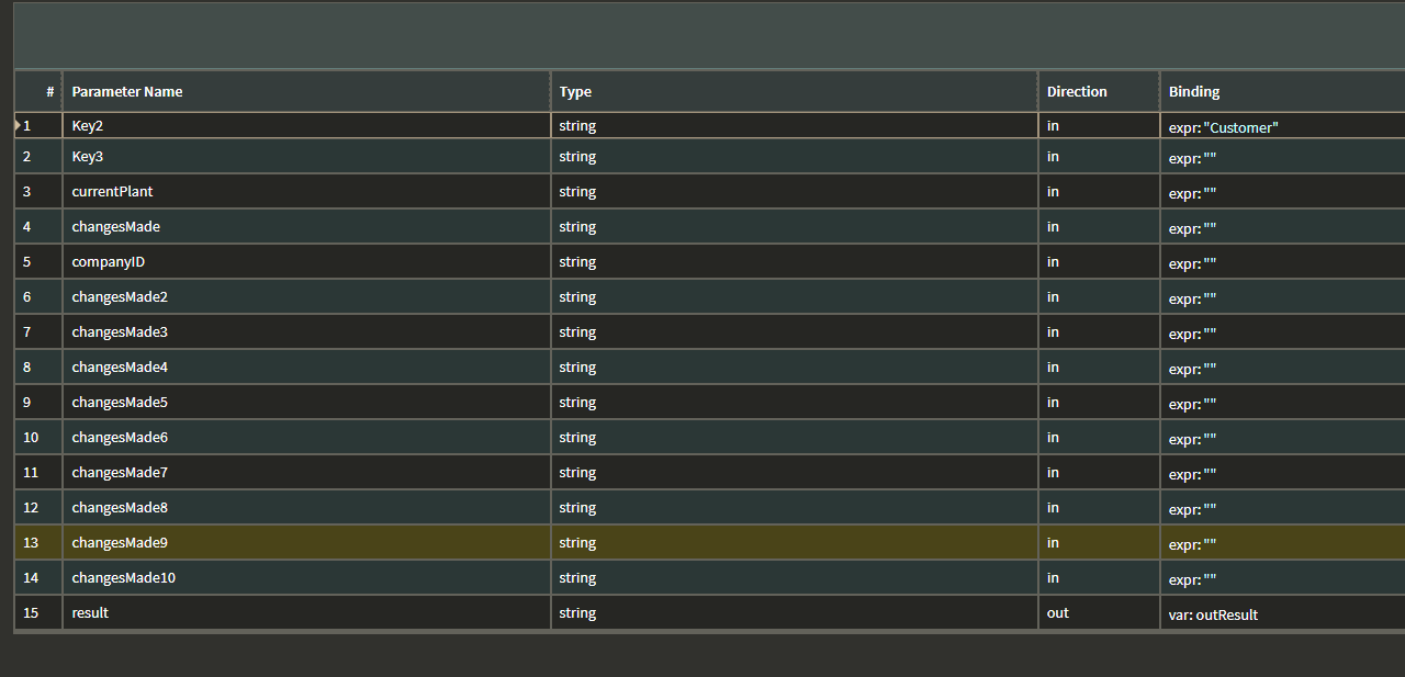

Configured vars:
All variables are initialized.
Pull all that out and just run the function and a message.

initialized vars

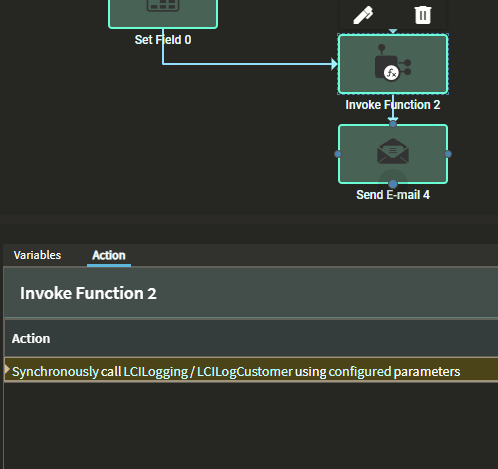

BPM:
(setfield and condition above is simple update custnum that has been in place and working for a year or so. new is function and further)

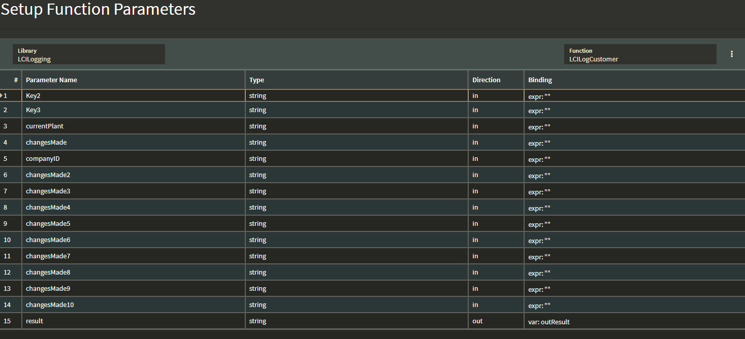

function action
configured params

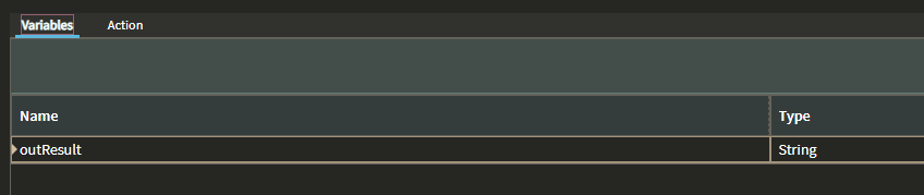

outResult is a string variable in the BPM

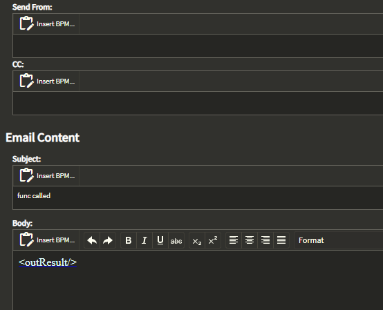

email template simply displays outResult as debugging helper

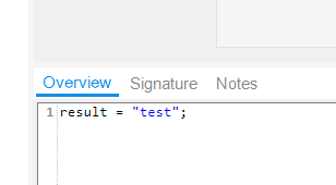

function:
    //code blocks are better... just saying...
//code blocks are better… just saying…
here’s the function
result = "test";
:laughing:

outResult variable is a string in the BPM (adding as much detail to this post as possible for sanity sake :sob:)

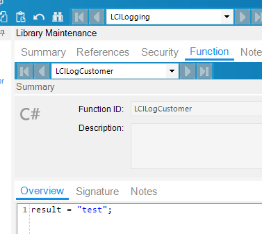

Function that is being called:
result = "test";

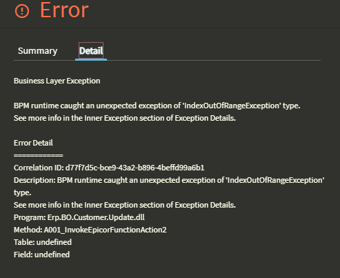

Error:

I have left the function signature alone but this should not matter… there is only a single line in the function which is the result = “test”; and nothing from the signature other than the out variable result are being used.

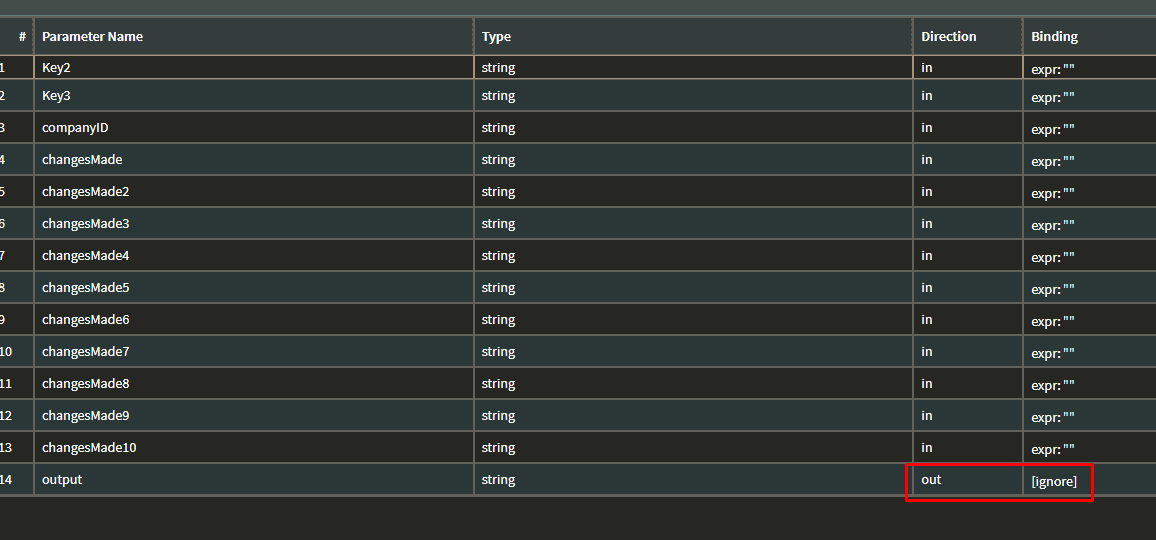

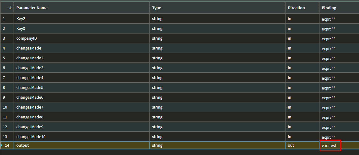

Confirmed that there is a bug (or gremlins) associated with response params.
I have left the code and the BPM the exact same. The only thing changed was I removed the response parameter from the signature of the function. This now runs without issue.
The indexoutofrange exception happens as soon as I add a response parameter to the function and map it to a variable in the BPM. If the response parameter is unmapped, I do not get an error.
Final thoughts / findings.
Function signature doesn’t matter. What matters is if you have a response parameter mapped to a variable in your BPM or not.
Working:
Produces IndexOutOfRange exception:
It doesn’t matter if you actually use this variable anywhere or not, but I receive an error as soon as I map this to any variable including a brand new one like in this example.
Function body being called in this test:
return;

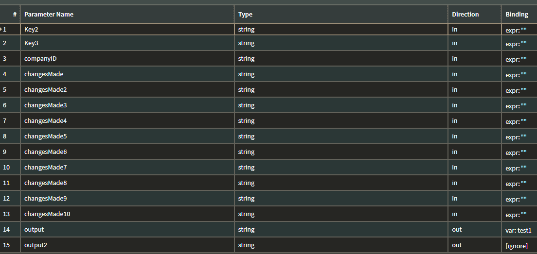

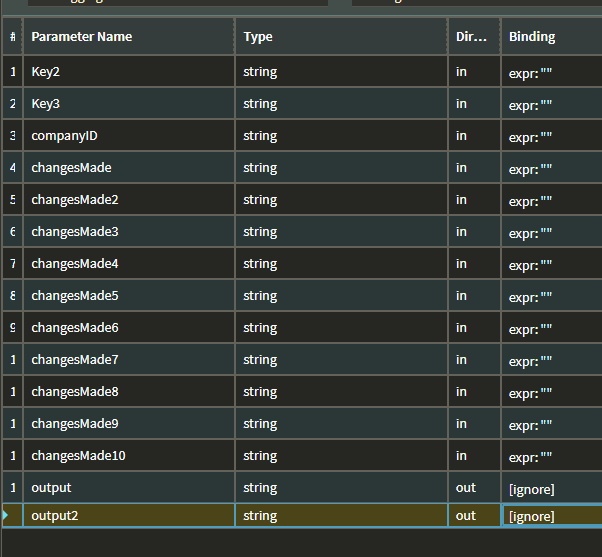

Do one more test.
Map the variable, just the one.
Add another output variable to your function.
Testing with:
First test = ignore both out params
Result = success
Second test = only first var mapped
Result = success??? :sweat_smile: very confused now
I’m not.
Even in code this happens. Now I know what’s wrong, and how you can report it.
What I don’t know if there is a workaround for widgets.
When you call a function in code with a single return variable, it looks like this:
string wut = (string)InvokeFunction("ColdMedina", "Funky", "invariables");
When you call a function in code with a multiple return variables, it looks like this:
string wut = (string)InvokeFunction("ColdMedina", "Funky", "invariables")[0];
string wut2 = (string)InvokeFunction("ColdMedina", "Funky", "invariables")[1];
//or
var ret = InvokeFunction("ColdMedina", "Funky", "invariables");
string wut = (string)ret[0];
string wut2 = (string)ret[1];

Just a guess, the input\output of functions used to be tuples (not sure if thats still case).
In C#, tuples, whether using the old Tuple class or the new ValueTuple syntax, have a maximum capacity of 8 elements for a single tuple.
If you want to confirm, copy your func, reduce the number of inputs\outputs to not exceed 8 (perhaps hardcode some of the inputs in test func). If it works, that’s your problem.
To get around it, you can pass in a dataset or serialized object.
