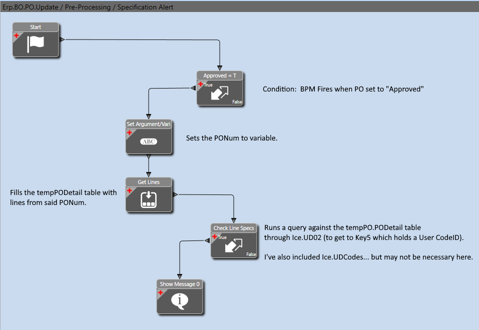

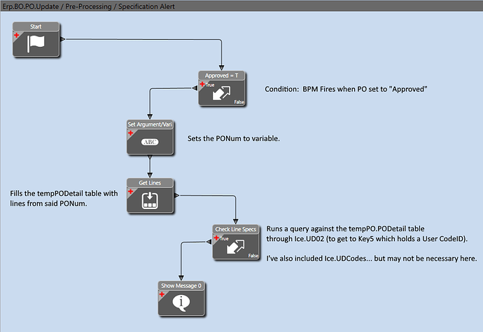

Business Case:
We have some parts for which we have internal specification documents which the Buyer needs to send along with the PO. We’re not set-up to auto-email Vendors because I want the buyers on the hook for reviewing everything and purposefully hitting “send”. So, I don’t need to do this via APR to attach a spec document or anything (although I may do that down the road).
What I’m looking for is just an “alert” message saying: “Hey one (or more) of the parts on this PO has an assigned specification, so pull that document and send it along with the PO.”
We store our Specification cross references in our UD02 table. So, Key1 is PartNum, Key2 is “SPEC” (along with other various possible values)… and if there is a row for a PartNum where Key2 is “SPEC”, Key5 holds a value of a UDCode (SPEC001 for example).
Below is the BPM as it stands… again, works. I can get a “warning” message to pop-up when there are (1) or more parts on a PO that have specifications against them.

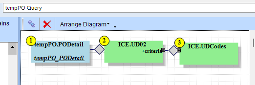

Here’s the Query in that final Condition:
Again, I probably don’t NEED Ice.UDCodes even referenced in this query, because queries in conditions don’t return data (or if they do, I don’t know how to access it). I’m just using it for a row count.

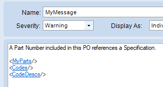

I set up my “Show Message” widget to display (3) separate lists (in order to test and make sure data was being returned:
My results look like:
part1part2
code1code2
description1description2
So, the string.Join() doesn’t seem to be comma delimiting anything.

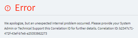

Well, that compiled fine… but I got the dreaded:
Maybe some day they’ll give Cloud users access to this… some day.
Like, how about today?
You can download the logs from Server File Download.

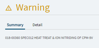

Okay… working…but only getting one line of results.
Should be two rows.
