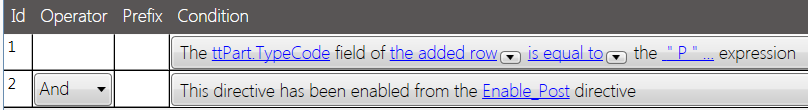

Then, on the Post-Processing directive I have a condition with the following:

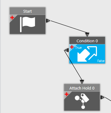

Issue is, it will not follow the TRUE path. Here is a screenshot of the flow. I removed the false path a little bit ago because it was always going down that path.

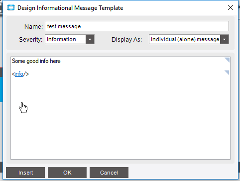

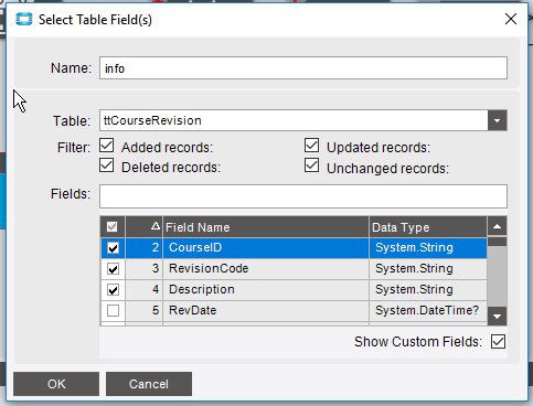

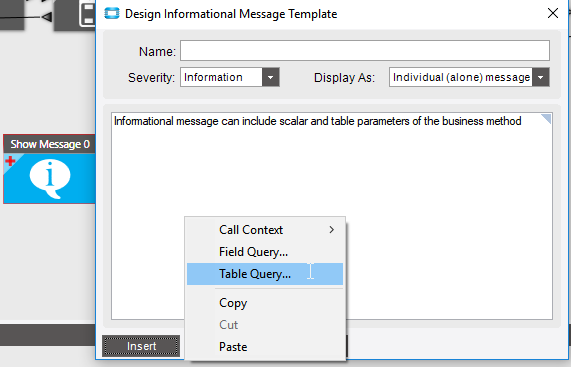

Whenever I’ve had trouble with a BPM I throw in pop up messages and at each stage so I know what things are flowing where, it really helps for testing. Then when you get it working, just delete the popups. Below are some screen shots of how to set up the message, it’s pretty easy. You can check as many boxes as you want in the table query. For a field query you get one at a time which is useful for inserting data into a sentence.

Oh man!! That was an awesome tip. For some reason, the RowMod field is empty on the Post-Processing.
