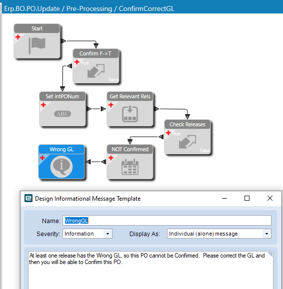

We put a in a Method Directive on PO.Update that prevents PO Confirmation if a wrong GL is selected. This only fires when the confirmation flag is going from false to true:

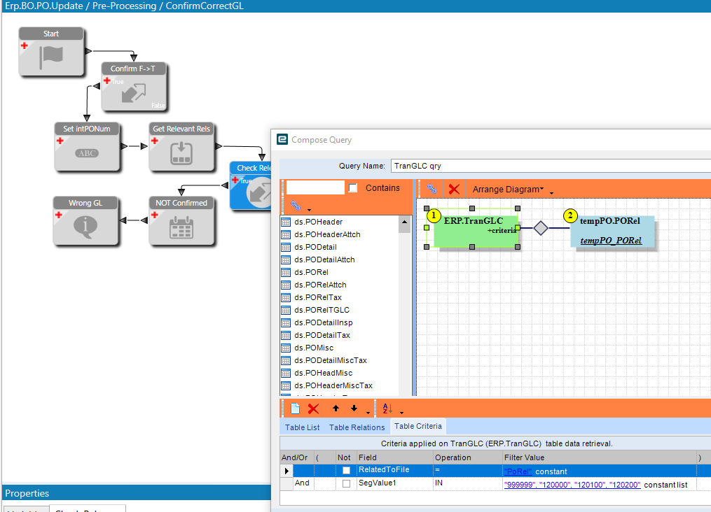

The next condition run a query to see if there are any hits for the wrong GL Segment:
We then set the Confirmed Flag to false and give the popup message.
Better to prevent wrong entry from the start, rather than send an email to another user.
