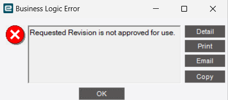

I am migrating a Client UI customization to a Server side BPM. This customization adds a operation to a Quote using QuoteAsm BO. I am making what appear to be identical calls in the BPM and the UI customization (thru the Adapter though) but in the BPM it is throwing the following message
Cannot manually update the Production Labor Rate in QuoteOpr.
Cannot manually update the Production Burden Rate in QuoteOpr.
Cannot manually update the Setup Labor Rate in QuoteOpr.
Cannot manually update the Setup Burden Rate in QuoteOpr.
But not in the UI.
