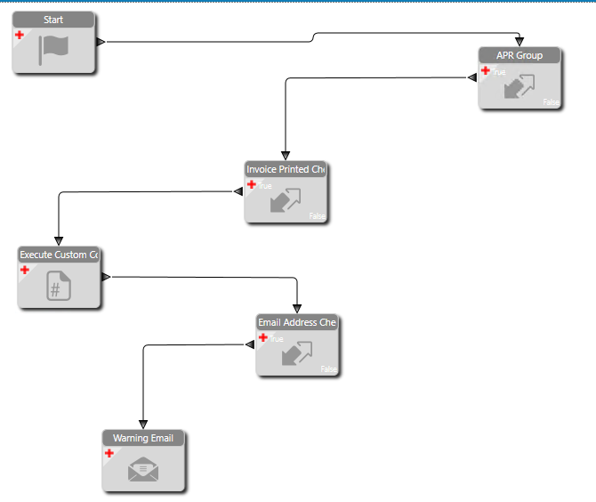

Do have Advanced Print Routing?
Excellent suggestion. I have made things too complicated by not using APR. Achieved my outcomes with APR instead of Data Directives.
Thank you very much, Calvin!
