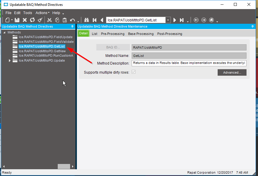

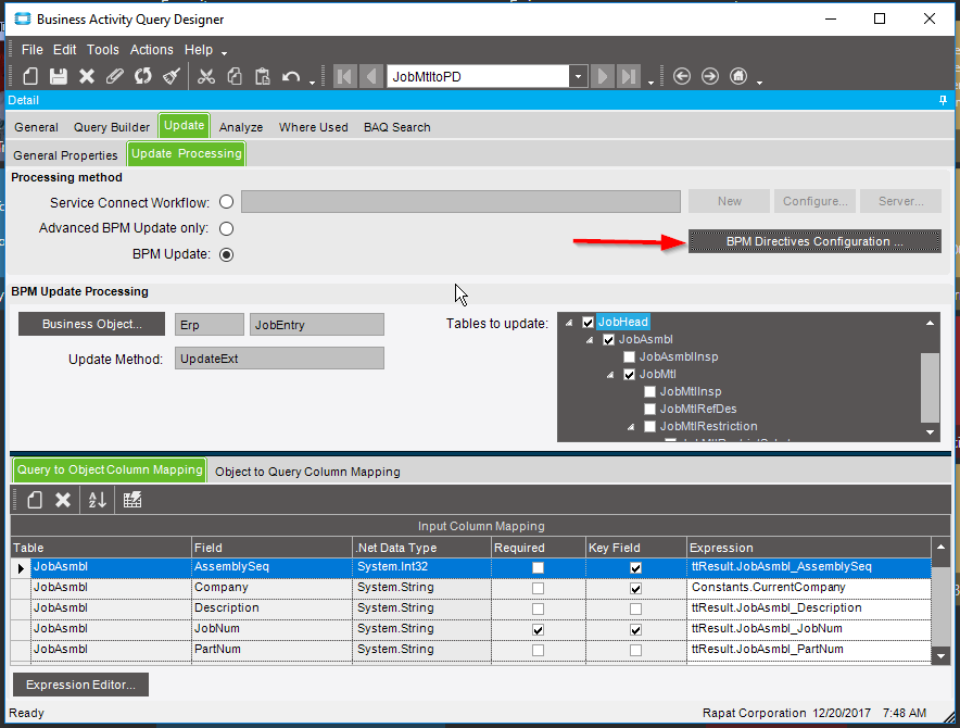

Well, I’m not an expert on UBaq’s so I won’t be able to tell you in detail how to set this up. But I think that where you need to go to get started is in the BAQ designer, under the update, update processing tab, there is a button on BPM Directives Configuration. Click on that, and it will bring you to where you can create BPM’s to work with your UBaq. I would imagine from what little you described that you would put it no the GetList method (although that would scare me personally to write something based solely on the BAQ with something I can’t clearly define well enough to not need the BAQ to assign the property, but maybe it makes good sense with your use.) Below are some screen shots to show where to go.
