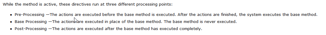

I have a handful of message boxes for debugging in this and related directives, but not a single one appears when the changed data error happens – not even messages in the pre-process directive that enables THIS directive.
