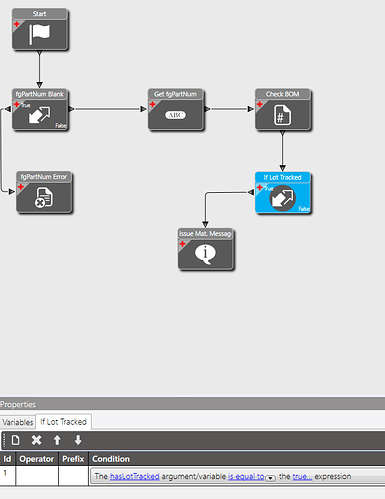

I sure can. Bear with me as I tried to organize it as well as I could so you could see everything I have:

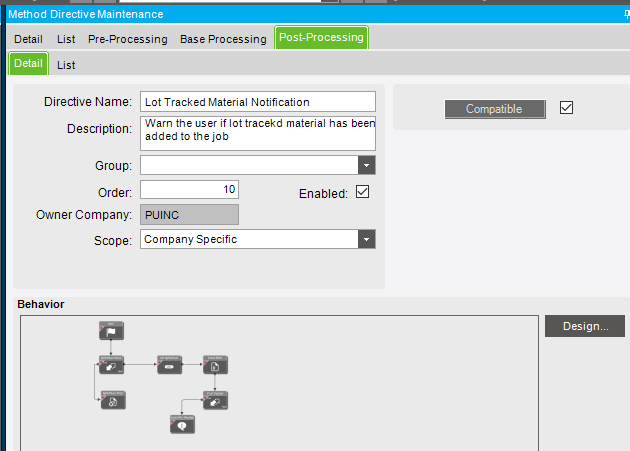

Here is the shell of my BPM. I used a post-processing method directive:

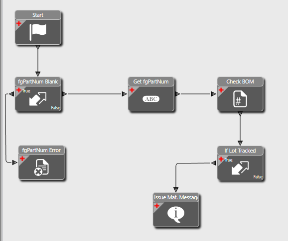

Next are some pictures of what I designed in the Workflow Designer:

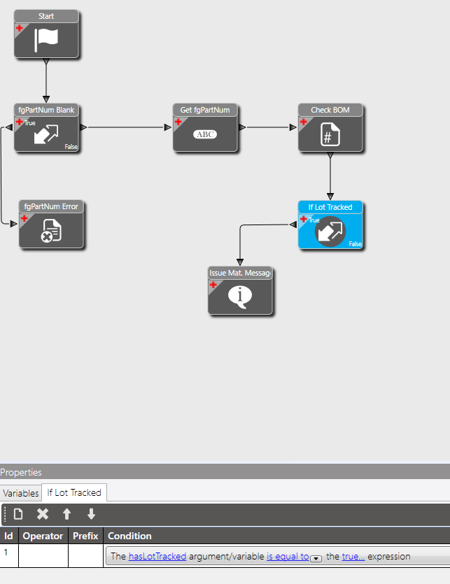

  1. The BPM as a whole:

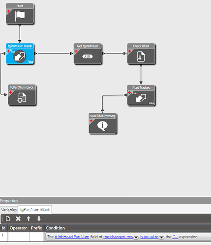

  2. The fgPartNum Blank conditon widget:

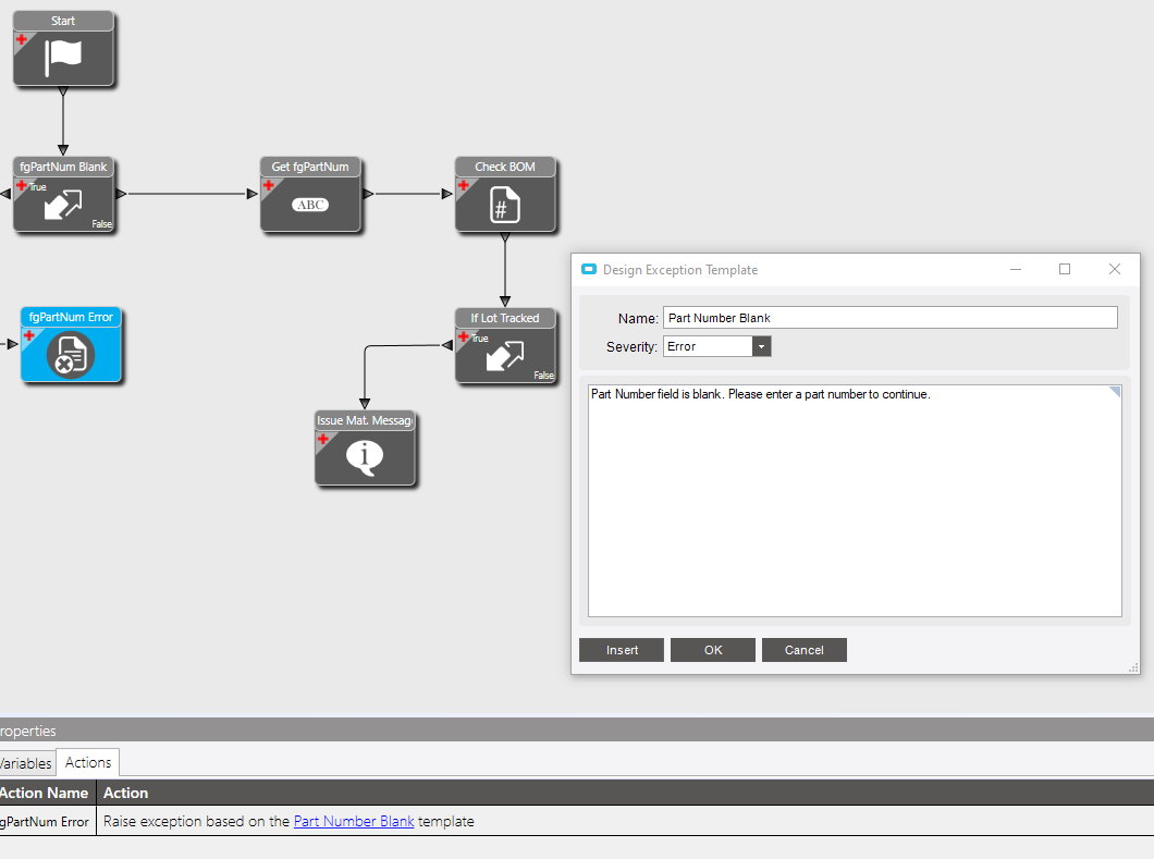

  3. The fgPartNum Error exception widget:
  • I will note that this seems to be working fine as I tested this out by attempting to move forward on Job Entry without entering a part number and it did trigger the notification I created.

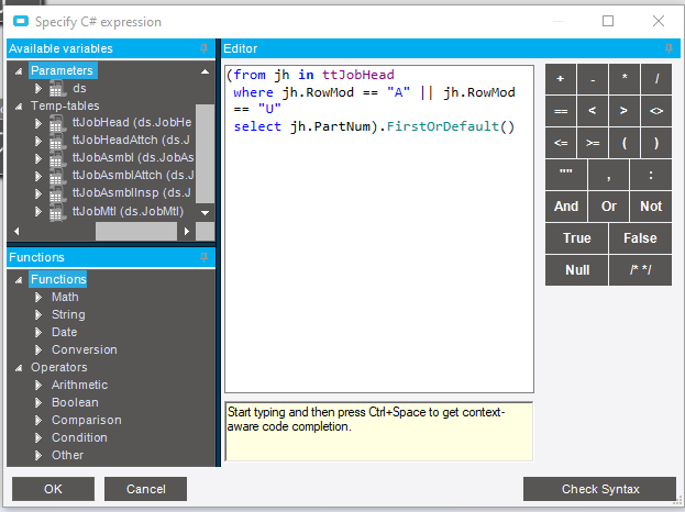

(Below is starting to where things seem to get hazy. Because I am not expert, I referenced some help from ChatGPT. I know… not the best place to go but I was desperate!)

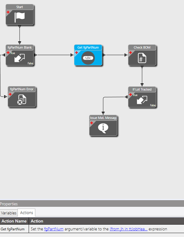

  1. The Get fgPartNum argument/variable widget:

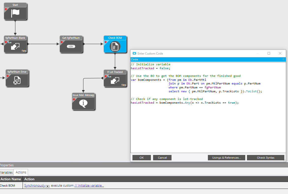

  2. Check BOM custom code widget:
  3. If Lot Tracked condition widget:

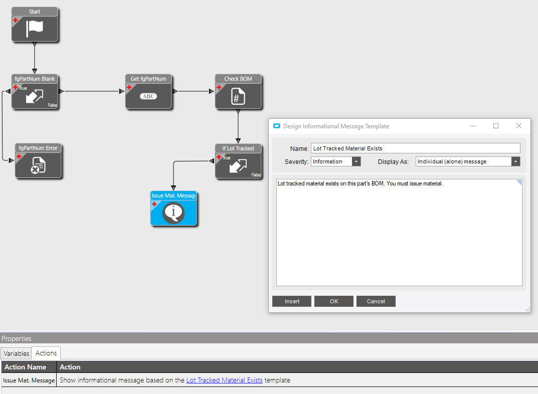

  4. Finally the Issue Mat. Message widget:
Hopefully this makes sense and gives you a little more insight into what I’ve built already. I’m sure I’ve overcomplicated this but not sure how to make it better!
it works is a good thing, but there are a few things that could be different.
You already have the PartNum in ds.JobHead, so yo can just use that rather than reading from the db.
Where you are doing the GetList and then the Any which is good you can just do .Any and the data will be checked on the server side and only the bool will be sent back, so a small amount of data is being sent.
Now I am not sure how this will be applied in the real world as kitters are not typically in job entry.
