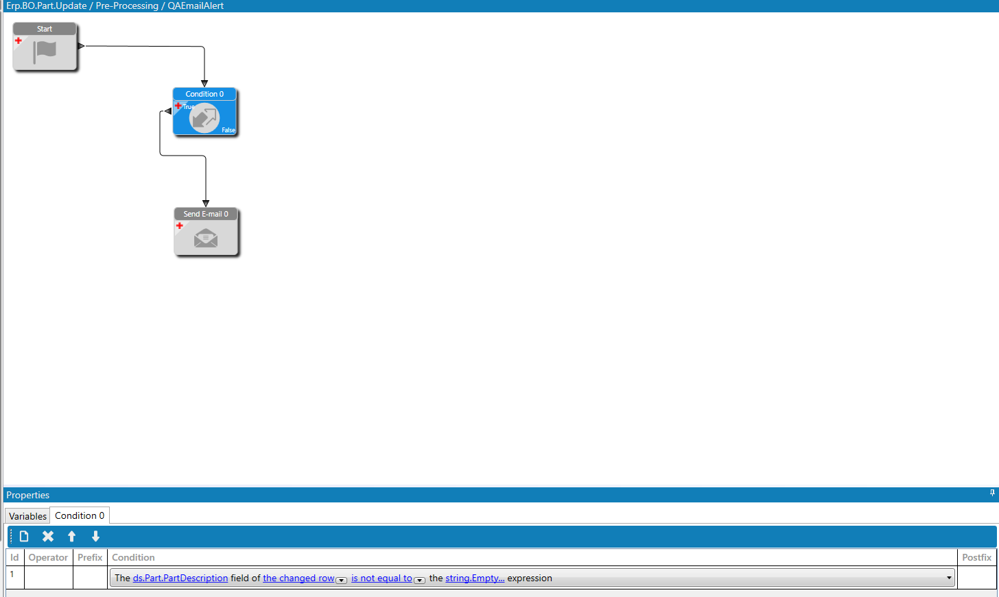

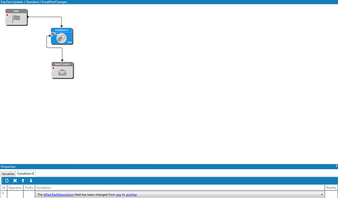

I am trying to get this to work, i have tried a DD and a MD but for the life of me i cannot get the email to fire.
Basically on this test i am trying to send an email if the Part description is changed BUT it will be used for other fields in the future. I have seen other posts where people have had similar issues and was wondering if there was something fundamental i was missing.

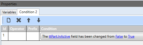

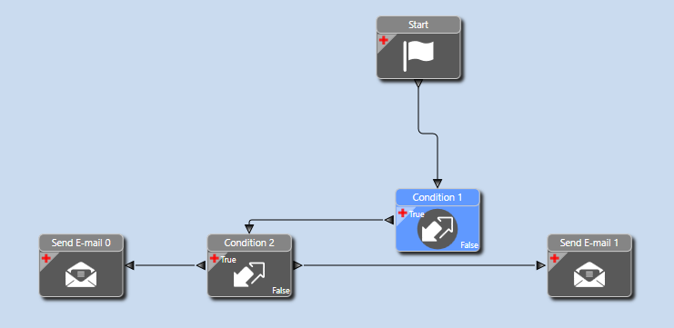

In the first example I can find quickly it is as a Data Directive - Standard:
In this particular one the secondary condition block is looking to see whether we are activating or deactivating a part to determine which email to send:
The first thing I would confirm is if your system is able to send email at all, I would put in a condition on my user having changed something obscure and then make the change to see if it triggered an email.
