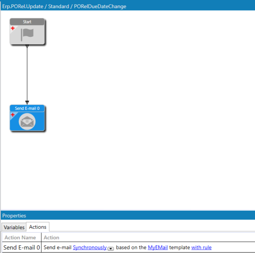

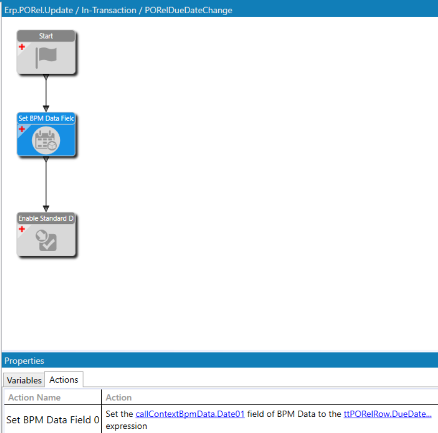

For email alert DD BPM, I use a “pre” In-Transaction BPM which enables a “post” Standard BPM
The pre does the conditional and sets callContextBpmData to fields I want to display in the email. The post BPM then sends the email. This way the update is for sure completed so no false alerts are sent out.
I am unable to capture the ‘before’ duedate. I am setting callContextBpmData.Date01 to ttPORelRow.DueDate but it keeps showing new duedate.

I was able to capture current due date and display old and new due dates in email.
I am using Std Data directive to set BPMDataField to ttPORelRow.duedate and then display new duedate via Post Method directive with ds.PORel.duedate. It was working and now suddenly I am getting error msg “There are no records in the table ds.PORel” whenever I try to change due date in PO.
