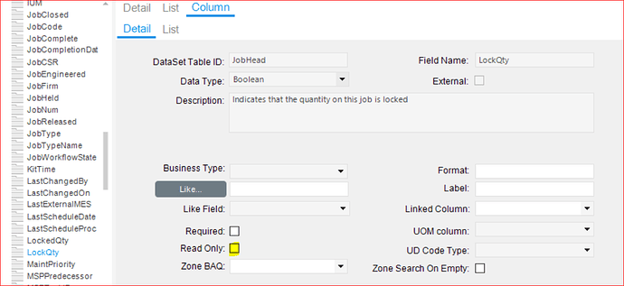

You may try row-rule. That should make your field read-only based on your condition.

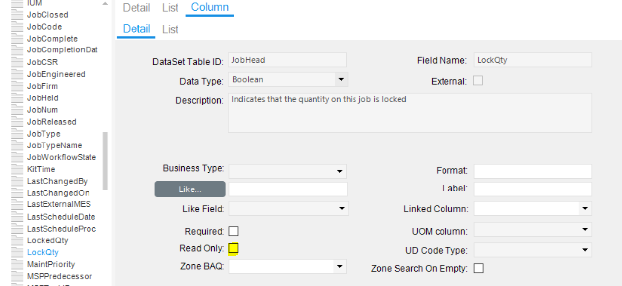

Additionally you can try this too.
from extended column maintenance
