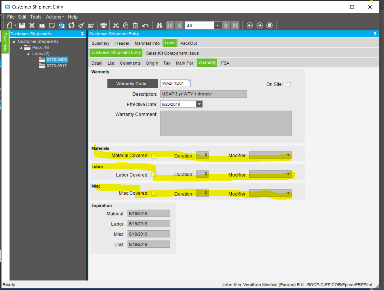

I am working on updating the warranty information at the time of shipment. Started development using the Data Directive In-Transaction on shipdtl table. The BPM seems to work but the BPM only update the Warrancy Code and the warranty description but not the Warranty Duration. Please see attachment.

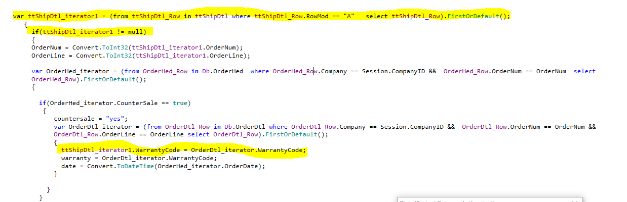

You can use following custom code in Data Directives. Also I have the code which I used to update the same values that may be you are looking for.
Let me know if I can be of further assistance.
CustomerShipmentWarrantyTabUpdate.txt (2.92 KB)

Thank you Vishal. Do you have any tips on how to calculate the expiration date? The expiration date is not being calculated.
