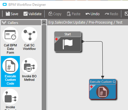

Hello @jkim
Give this a try - it gives you the option to throw an error message or to auto change the entered date to Monday

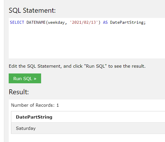

you can also stamp the order date to a parameter ( on @LBARKER BPM) then run a SQL expression statement in a criteria (Saturday or Sunday) or any day you want, if yes then raise an exception with informative message.
DATENAME(weekday,OrderDate)
