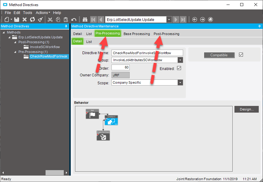

This might be just me so feel free to delete.
In the Method Directive interface, if I select a BPM group with both pre and post processing directives on it, the BPM tree view puts Post processing directives on the top of the tree.
Surely it’s putting these alphabetically, so I get it, but it would be nice if it matched the UI so as not to be confusing as to which directive I’m selecting.
Since the UI reads from Left to Right, it would make sense to me for this tree view to match the left-right with up-down as well.

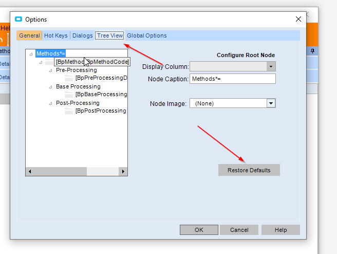

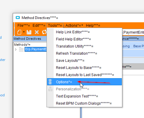

Try

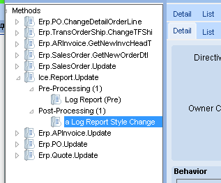

For me, pre-processing is on top:

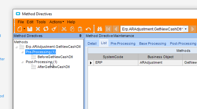

But not sure why the Post shows first in your tree. I also see Pre’s first.
