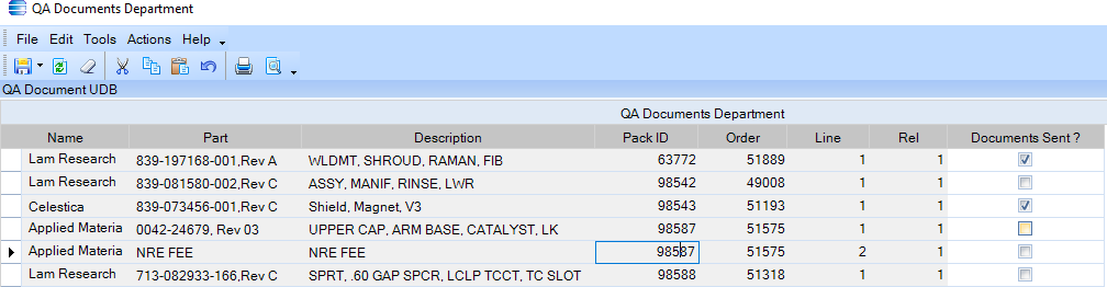

We are given the task to restrict packing slip if certain documents is not being sent . C of C or FAI , the problem is these documents are sent out through email or shipment . We came up with a solution through BPM (If we can get it to work) . These FAI documents are per Customer PO , so we decided to use the UD: Example OrderRel.Checkbox10 labeled “FAI Required” in the Release tab is checked if the Customer requires the FAI Documents (Sales). Than creating an updatable dashboard for the QA to check the ShipHead.CheckBox10 if documents received (QA) . Thus allowing the packing slip (Shipping).

ShipHead.CheckBox10 = Checked (Documents Sent)
