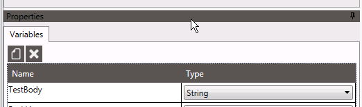

Variable is defined in the BPM via

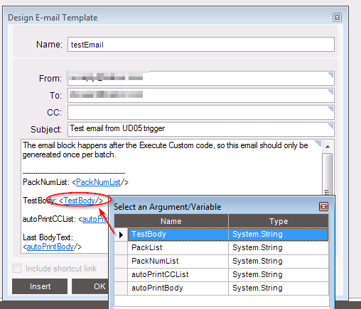

And then referenced in the Send Email block via

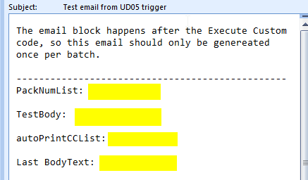

The email from the Send email block does execute, but all the variables are blank.

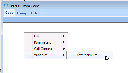

I right clicked in the text editor of the Exec Custom Code,
and get
does the this object somehow limit the scope of the variable to the Exec Cust Code block? I thought this was the whole BPM.

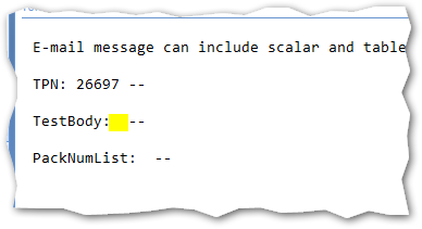

the TestBody line is commented out. I’d expect it to be unchanged from when it was set in ECC#1
With the above, the email I get (from the Send Email block) has:

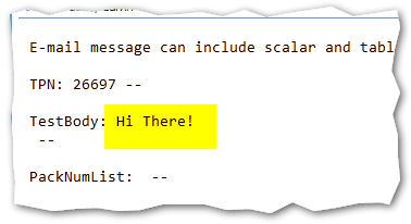

If I uncomment
// this.TestBody="Hi There!\n";
The email contains:
