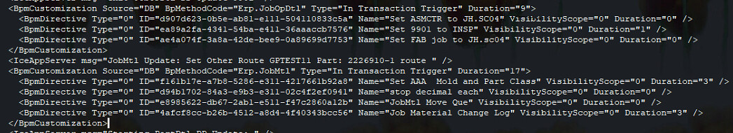

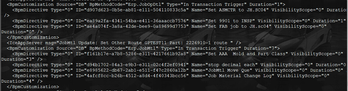

I did a quick test on my current test 21.2.10 and a 23.2.8 I made a couple of weeks ago with get details in job entry for the same assembly and quantity and it is similar 9 and 17 versus 1 and 7
2023.2.8
2021.2.10
