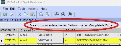

With classic dashboards I used the “Grid Caption:” area to add Help on how the dashboard worked, how it was filtered, etc…
Where would be a good place to display a simple 1 line dashboard detail note on how it’s filtered and what is displayed.

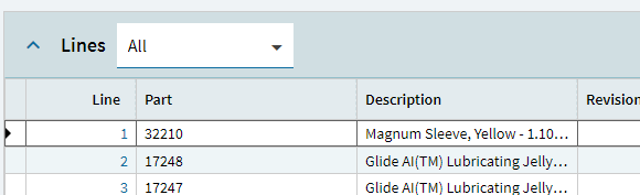

Panel header? You can add objects, a text box in your case, and input the desired caption in the display.
Here’s an example from AR INVOICE TRACKER which adds a line filter to the panel grid header.

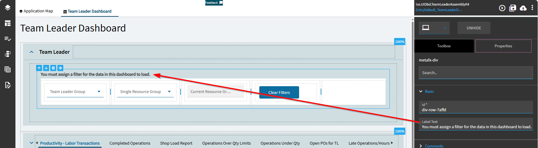

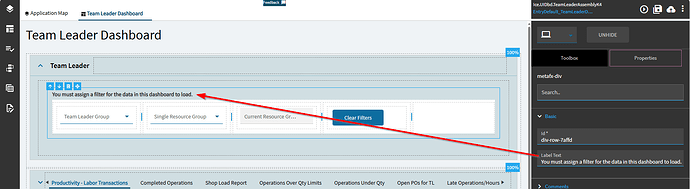

You can do something like this:

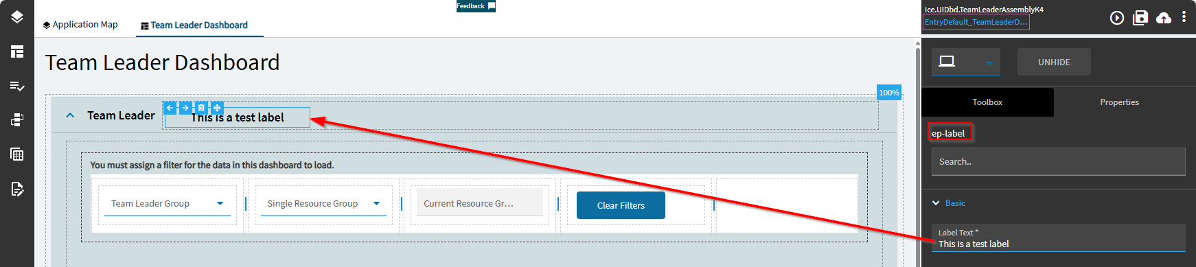

Or this:
