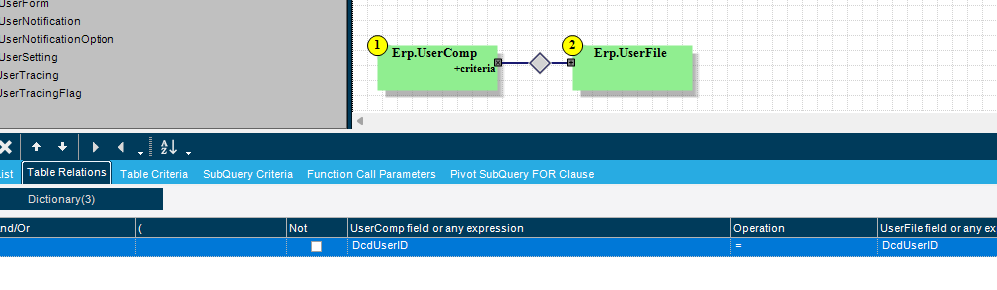

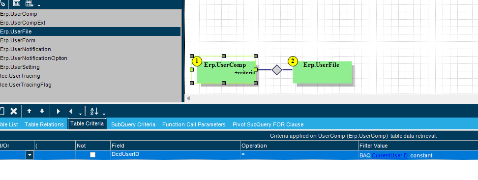

You should be able to use the UserComp table with the criteria DcdUderID = BAQ Constant and choose CurrentUserID. You can then link that to UserFile DcdUserID = DcdUserID and pull the EMailAddress field from UserFile

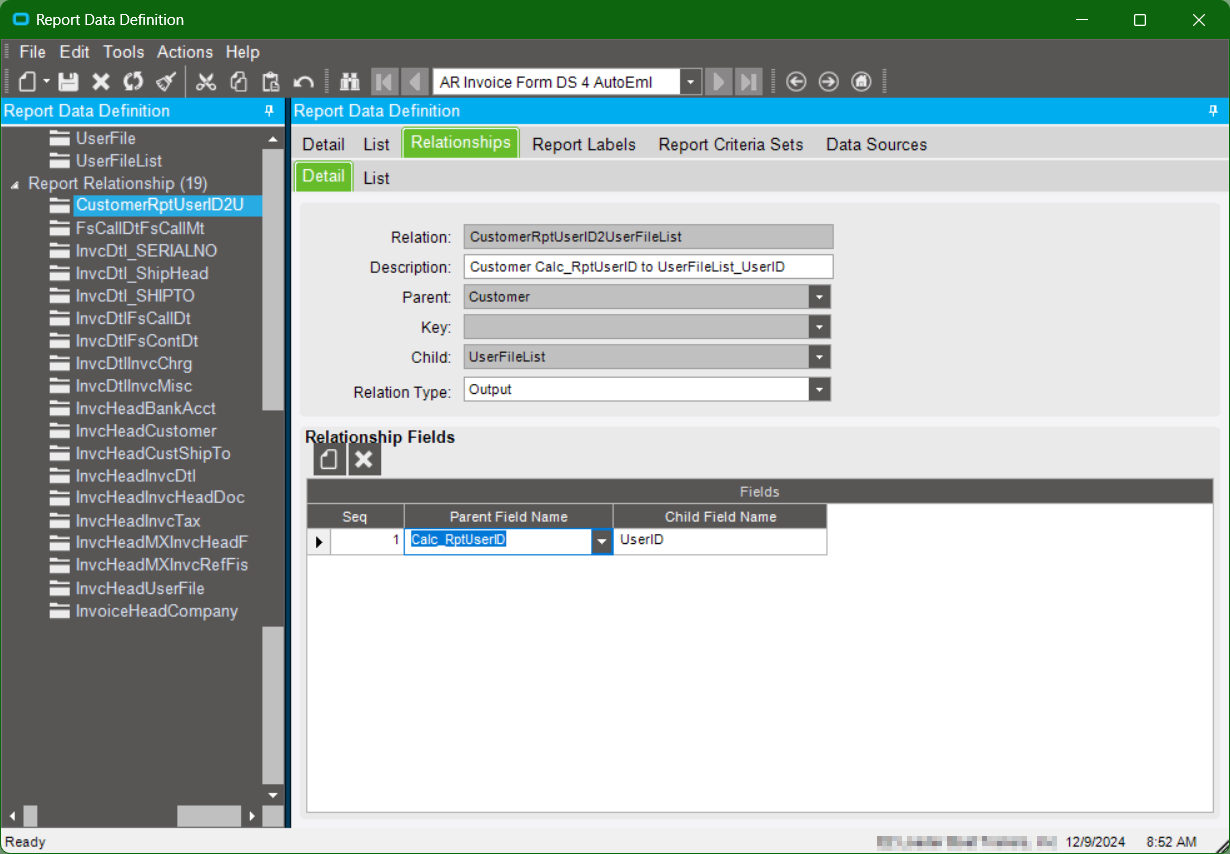

You need to link on the UserFile or UserFileList to Calc_RptUserID

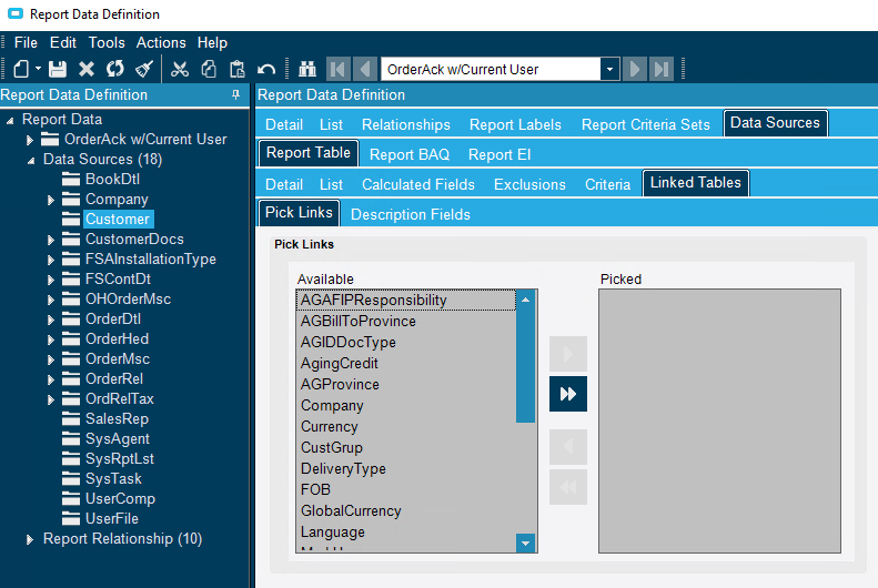

I’m not seeing it anywhere.
That’s a new trick for me. How do you get the Calc_RptUserID on the Customer Table?
It’s a black box, if Epicor hasn’t put it as part of the base rdd you can’t add it.
without that, Clint’s solution will not work
Exactly.

No such Links available

this solution works perfectly in ARForm, Thank YOU!!! (that’s next on my list and it’s solved already :sparkler:
unfortunately it doesn’t work the same in OrderAck :worried:
