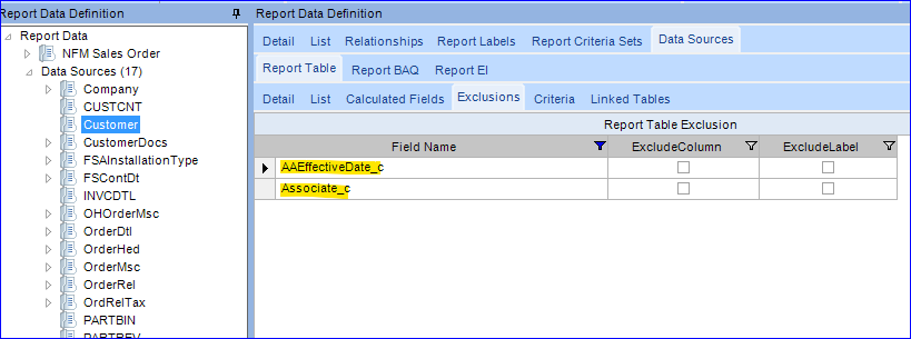

But, below is OrderAck RDD and the UD Fields are included in my Exclusions:
I filtered for columns containing “_c”… my two UD columns are in there.

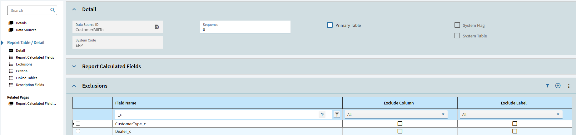

Thanks @dcamlin , mind just copying the PackSlip RDD and checking? The tables in the PackSlip are not called “Customer”. Epicor gave them aliases and I was wondering if the UD fields still carried over with the alias name.

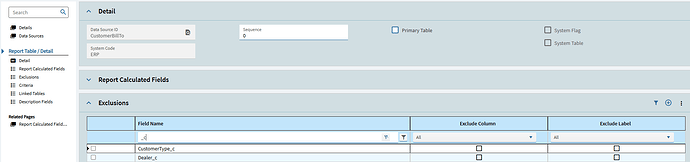

They do show the UD fields in the CustomerBillTo Data Source for the Pack Slip RDD:
They do NOT however appear to be included in the CustomerShipTo Data Source.
