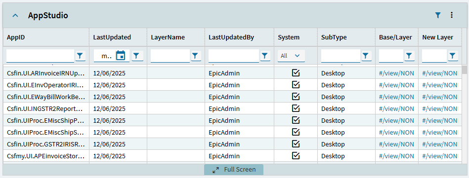

Here is some example code from my DevTools dashboard where i am building URLs to load into App Studio with the appropriate app/layer (this is from a function):
These are relative URLs to the current page, which should preserve the base url https://{stuff}.epicorsaas.com/{environment}/apps/erp/home/)
You can use Session.AppServerURL to help with building the URL.
x = $"#/view/NONID12345/{app.Key1}/designer/pages?layerVersion=0&baseAppVersion=0&useBroadcast=1&company={Session.CompanyID}&site={Session.PlantID}&isNewApp=false";
y = $"#/view/NONID12345/{app.Key1}/designer/pages?layerVersion=0&baseAppVersion=0&useBroadcast=1&company={Session.CompanyID}&site={Session.PlantID}&isNewApp=false&layerNames=";
These feed into a dashboard:
