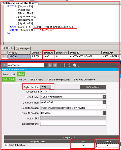

I am bringing over a bunch of reports into a new E10 version, but solution workbench isn’t retaining them as the default. Instead, I have to open up each report style and set these custom reports to default. Any way to do this in bulk? I can’t find which SQL table to write a query on.

As far as I know, the table ReportDefaultStyle isn’t exposed to users in E9 or E10.
I’m not sure if business logic is doing more than just updating this table.
You might be able to update directly via SQL but… I’d be extra cautious and verify everything on a test system.
When we went live with E10 we used the vanilla version of our database (a database without any default report styles). During the upgrade procedure I ran the following SQL. You could change it to an update if you need to do a mass update / change. We didn’t have any problems.
