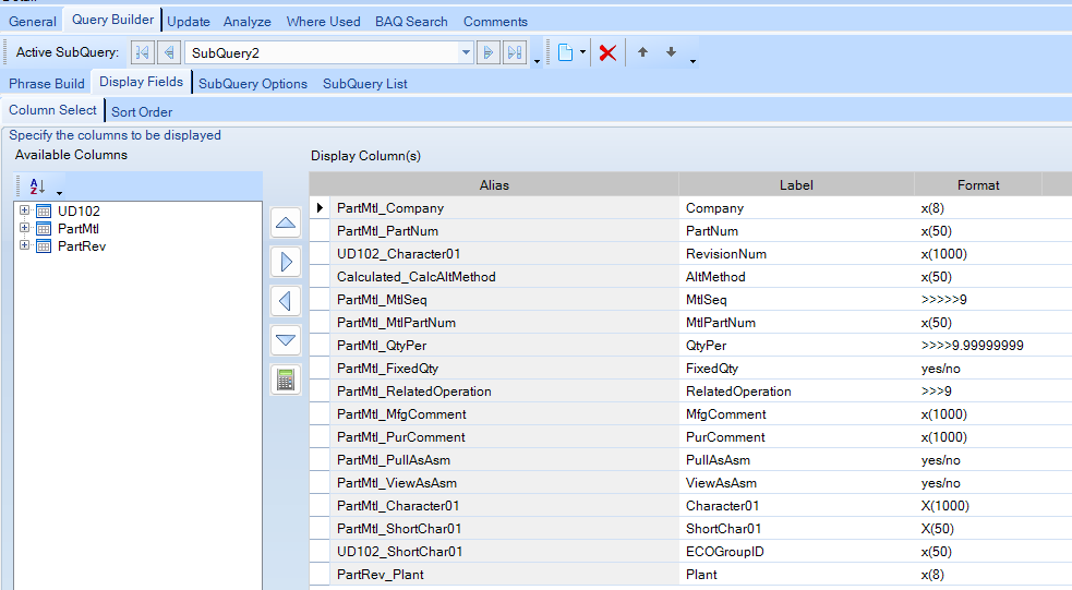

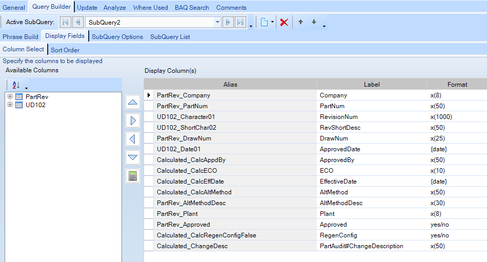

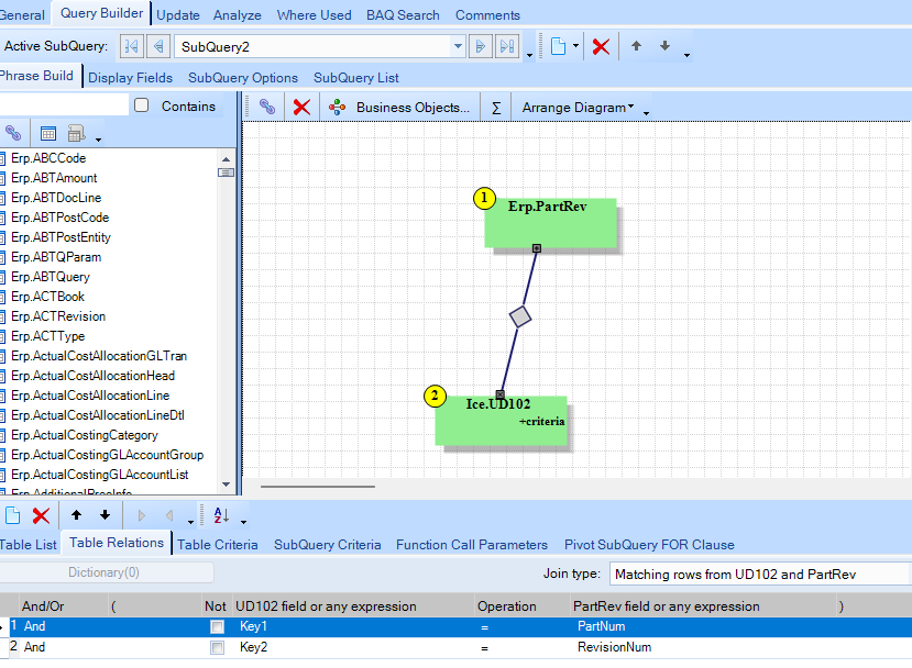

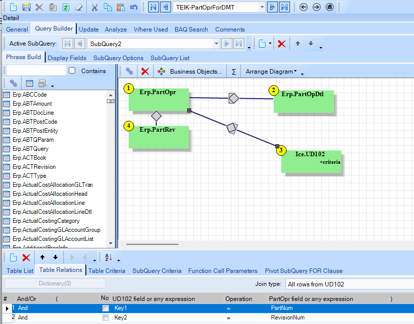

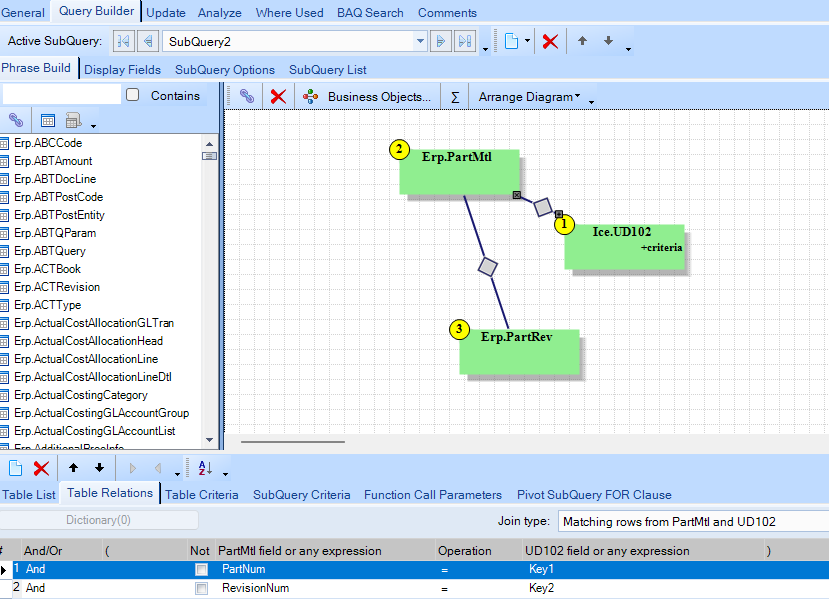

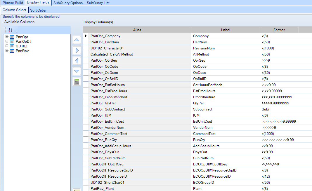

We use DMT significantly to add and edit parts and methods. My favorite way to work up data files is to use a UD table to house the parts whose methods I want to mimic or edit and then a query to get the part, part plant, part rev, partmtl, and partoper data out. I would only query out the fields required and the fields you want to use. The more fields, the more the chance of it choking on import.
In case it’s helpful, here’s example of one I’ve used for getting the partrev, partopr and partmtl in for subset of parts / revs stored in UD102. These were used to make new method revisions.
