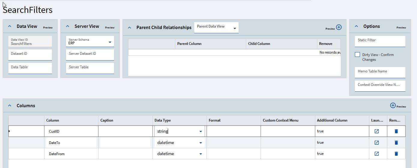

For search fields I use a dataview and have a button to clear the dataview fields.

For example we have a drop down combo with hard coded yes and no values. I created an EpiBinding field so it is accessible like TransView.UserResponse. Then I use that in the dataview query filters.
So if I want to clear the drop down or text box, how do I do it once user clicks on a button “Clear Filter”?
How does that button clear the dataview fields? How do you make the click event do the field clearing without coding?
Event: row-delete
